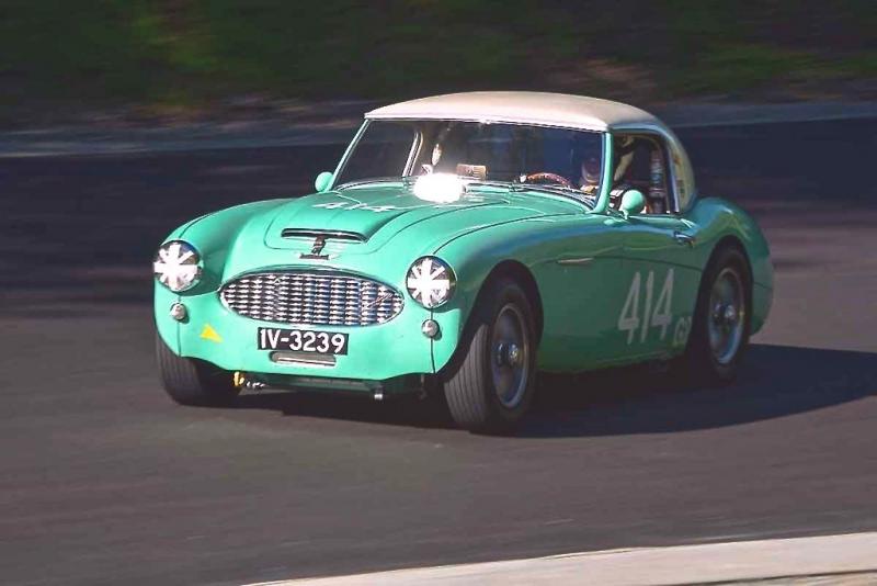

I've been happy with the DWR high ratio unit I installed in 2017.
