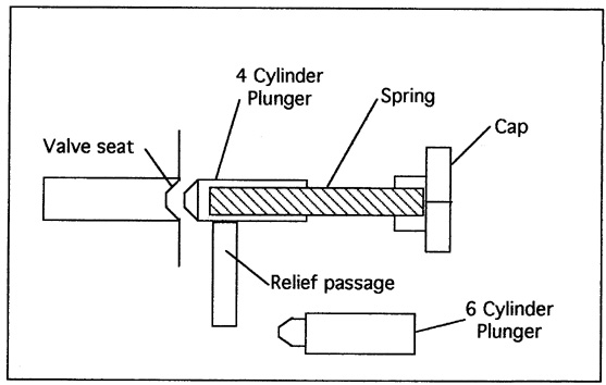

I think there are two separate problems, not related. The "first", may or may not be a problem. With the rocker cover off & the engine idling, there should be a small oil flow from each rocker arm. About one drip every one to two seconds from each rocker. If there is no flow, loosen the copper feed line from the head to the rocker arm stand. There should be a lot of flow. If there is none, the oil feed passes through a hole between the block & the head. This small feed hole is located directly under the rear intake port & about an inch or so inboard from the outer head surface. It would be possible for this passage in either the block or the head to be blocked by something such as the head gasket itself, gasket sealer, or what ever.
The high oil pressure could be a binding pressure relief valve or the spring is not going fully to the bottom of the cup shaped valve or fully into the cap. It's barely possible that you have the wrong valve plunger or the wrong spring. The Fours use a different plunger than the Sixes.
See attached sketch.
D

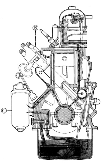

If it will help I have attached a pic of the BN oil circulation.
D
