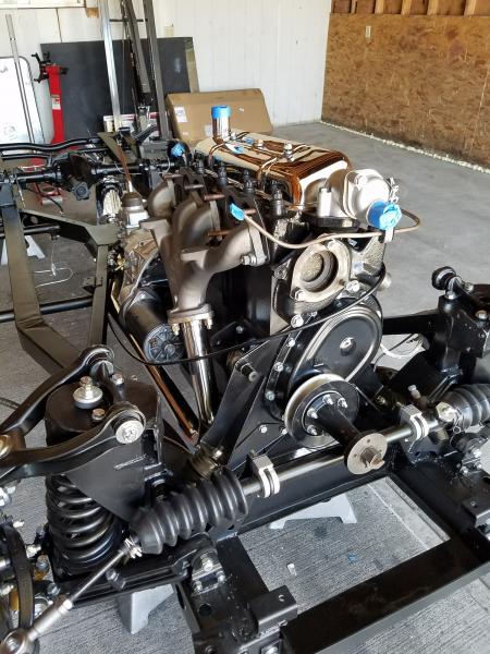

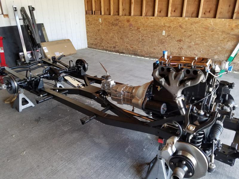

Interesting. Mine are the TRF ones as well. Or did I get them from VB? I can't remember but they look exactly what came off so I'm confused and I didn't swap out the springs. I put the wishbones on the same way they came off but here are a couple pics. Let me know if you guy see anything. Don't pay attention to the shock installed on the passenger side. I could get the upper in but couldn't align the four studs to the bracket on the shock. I thought maybe those were supposed to go a certain way but I mimicked what came off.

Your springs look like they are "bowing out" causing the shock to rub. I dont think they are supposed to do that. But I don't know why the would do that, are they the original springs?

Yep...original springs. Just repainted. And the shocks I bought match the originals that came off. The springs are the short springs with the spacer. The ONLY thing I changed was taking out the corroded rubber bushings and putting in blue poly between spacer and shock tower. Then the lower and the one between the spring and the aluminum spacer is the black ones that came with the TRF kit. They are seated properly as the first time when I used the black one between the aluminum spacer and the shock tower it wouldn't sit right. Looking at the other post about suspension my bow doesn't look any worse than his which confuses me. I swear...the VW and Audi suspensions I dealt with in the past were far more complex than this and easier to resolve.

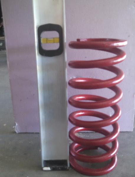

Gary, check this out..I was getting ready to install the spring on the other side and just for grins I put it next to a level. You see what I see? It has a definite lean and if I move the level to the other side, the lean is reversed. Have no clue if that's normal or if over the years it reformed itself that way. In any case, I'm gonna reuse it because the height is right and no cracks but seems to me, given the lean it has, that the orientation of the install may affect the amount of bow. I just gotta figure out which way that is. Wondering if perhaps yours may be the same way. Would explain a lot if my theory is correct.

Your upper wishbones appear to be correct to me. At least they look the same as my TR4A. Sorry I can't be of more help; but the conversation here contains some good ideas.

I found that the springs in my car had a slight curve when mounted and at rest, so I cut/made a bevel on the top of the spacer that I used...the spring now sits straight at rest.
