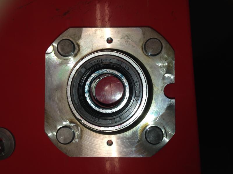

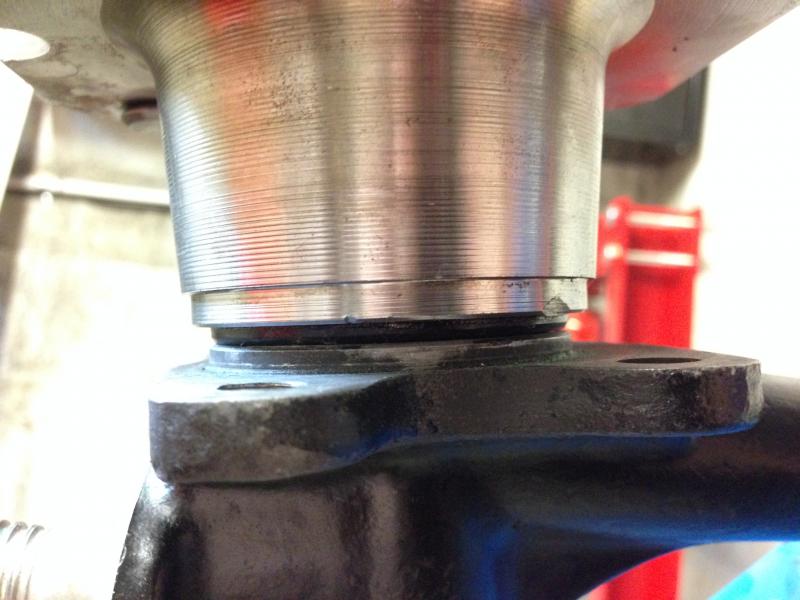

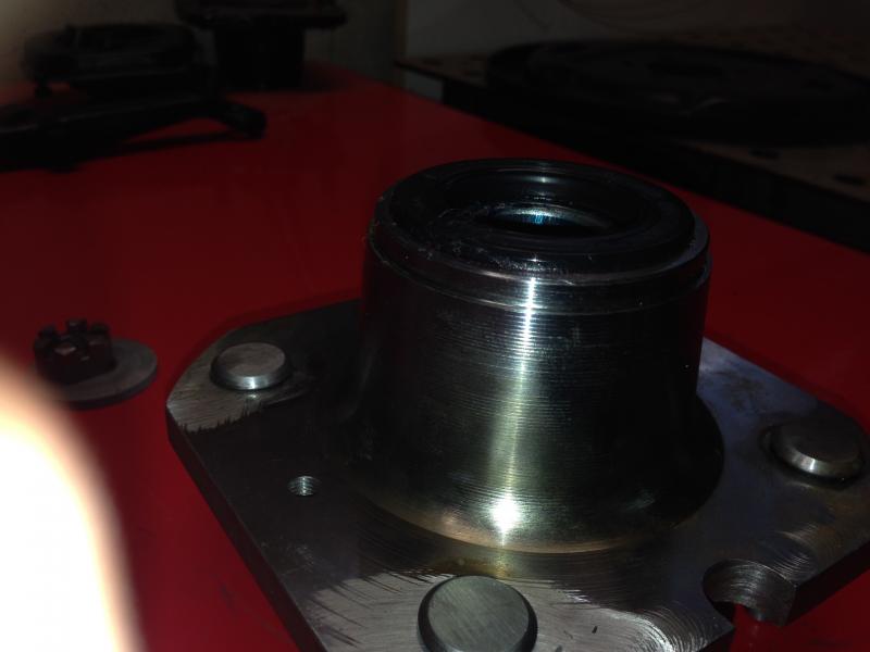

Yeah the ones i have from rimmers are more like 54 on a vernier, sorry i havent got a mic to be more accurate. I dont mind being the pioneer on these nitrile seals i have coming, ill get it all set up and post some picks soon
Cam
R
raskas
Member
Okay guys. My metric seals have arrived and ive fitted one to the new hub, size is 53 x 35 x 7. It tapped in nice and snug on the hub with a touch of loctite flange sealant and is sitting well on the step in the vertical link... fingers crossed it does the job.
