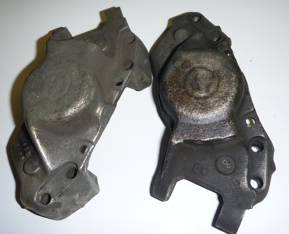

I'm getting my Jag calipers ready for rebuild. Have cleaned off all loose grease and dirt using laquer thinner but they're still really grungy. I'm planning on painting them.
Do they have to be media blasted or is there another chemical I can clean them up with which won't etch the piston bores?
CalipersForCleanup.JPGThese are typical but all the pieces are similar.

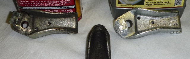

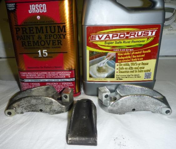

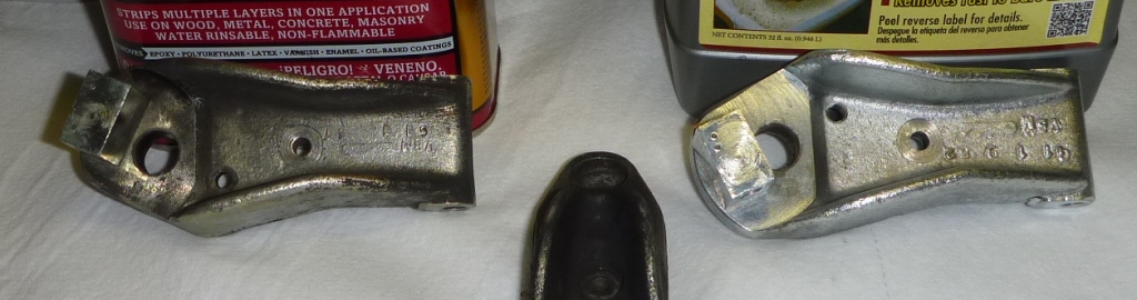

Followup - Original with Meth-Chlor Paint Stripper vs Evapo-Rust:
Both were carefully pre-cleaned to remove dirt & grease; both soaked overnight and washed with Dawn and a bronze brush.

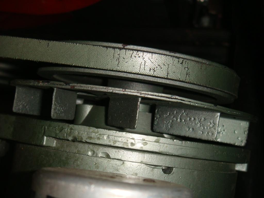

Careful with that evapo-rust stuff, it can ruin parts very quickly. I tried dipping the engine side plates and the generator fan in it overnight only to find a mass of small craters had appeared all over the parts. Apart from looking rather ugly, the metal inside these craters is 'active' in that it will start rusting immediately even if painted.
Paint stripper doesn't make things look as pretty because it doesn't attack the steel/iron but also it doesn't activate the surface so no problems with spiderwebbing under the paint. I'd recommend dipping any parts exposed to evapo-rust (and any coarse blasting media) in weak phosphoric acid to neutralise the surface before painting. Read about active and passive surfaces on Wiki https://en.wikipedia.org/wiki/Passivation_(chemistry)

Here is a pic of my generator fan after evapo-rust treatment.
Andy.
