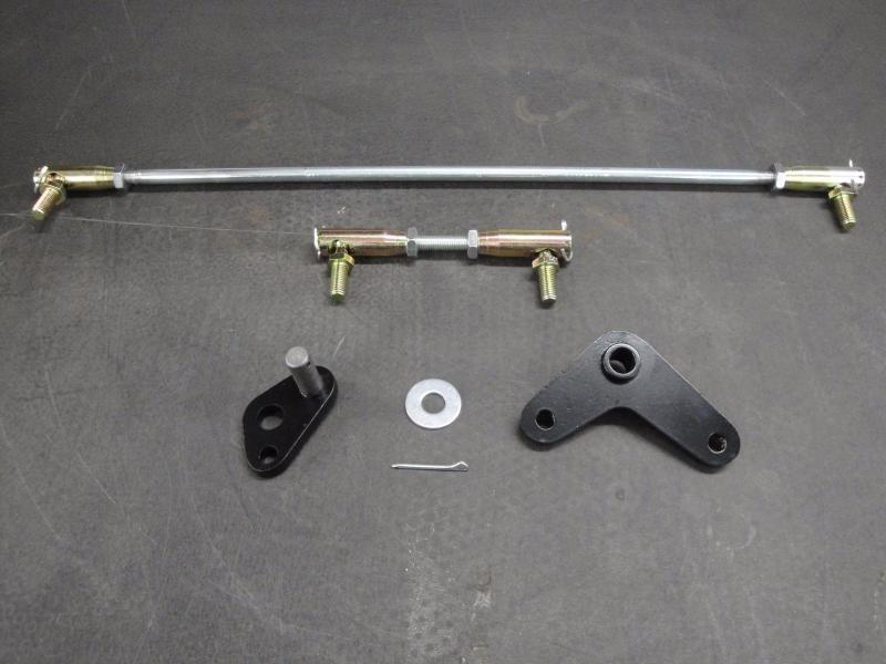

As I'm having my carburetors rebuilt by Joe Curto, I want to make sure everything around them is in fine working condition. The original linkage feels a bit "sloppy," it may well be the pivot/bellcrank on the manifold is worn. It feels like the forward part of the linkage binds or hits the manifold as a result, so I've purchased a very nice replacement throttle linkage from Britsport (they sell them on eBay). It's so nice, new and shiny, it qualifies as under the bonnet bling...
My question is this: There are four threaded ball joints on the linkage. They feel "tight," you can adjust them to loosen them up. How loose or tight should they be? Move freely or with some friction? Also, I imagine they should be lubricated, if so, with what?

A small amount of friction is OK. The book calls for an occasional drop of oil; but with the original type that can be disassembled, I start out packing them with grease. (I don't know if Britsport sells original type, or the more modern ones that can't be disassembled. Used to be you could buy those pivots from a semi truck dealer, but I haven't shopped for them in many years.)

Those balls get egg shaped over time, so if you do have new ones, nice. Plus Joe would be a good guy to ask about those ball joints. I have been collecting them for a while off eBay and parts cars. They used to sell something similar at parts stores, but they were a little bigger. For oil, I am using that Teflon stuff because oil will gather dirt and small chunks of sand.

Attached is a photo of the Britsport linkage. I think it's is very well-made. The also make the pivot set-up only, but the difference in price makes it worthwhile to get the whole linkage.
I took my old one off, then matched the new one to length by adjusting the outer linkage housings. I took them apart and lubricated with grease around the ball joints inside (there's a spring and two cups, one is adjustable by screwing down to maintain slight pressure on the ball). I intend to install it in the next day or so. I also checked the pedal return, which is obviously freer without the linkage attached, but I think this will help. I don't want to take the pedal apart at the moment. I'm hoping the combination of new linkage and rebuilt carbs (and the distributor, which is on it's way to Jeff Schlemmer) will do the trick.

That looks like a nice quality original set; I like it, and it is from Seattle. Time will tell how long they last; I am not sure how hard the steel balls should be, but my guess is a hardened material. I would tighten the ball spring combo tight enough so they do not come out and lose enough for free movement.

From the eBay description: “The bellcrank pivot plate and lever are machined from mild steel, the pivot pin and socket are made from hardened 4130 Chrome Moly, then silver soldered together, not brazed as original.”
I installed it yesterday and it went in fine and looks good, too. I lubricated the pivot joints with grease. We’ll see how everything works when the carbs come back.
