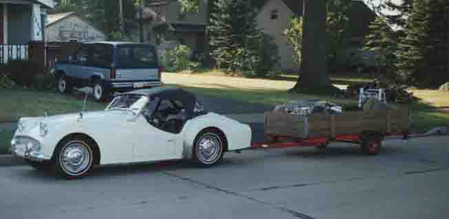

Got_All_4
Everything you can!!
Seriously though a set of points, extra oil, spark plug and wrench waterless hand cleaner, rags and a fan belt.
