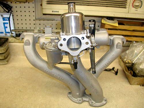

No, but I'd like to see a photo if possible....is it the same design as a ZS manifold?
glemon said:
Tony, my MGB (80) has a manifold from a '71 Marina, or at least that is what the previous owner tell me, not cat. converter, but a single unit intake exhaust manifold, previous owner said he thought or heard this was a better unit than the late B one, do you know anything about the early 70s Marina manifold?
It is a single carb manifold and I too am thinking of converting to a dual carb.
Does it look like this one? (Photo from Jimmy Hilton)

Well, I know it isn't that clean, I will take a look when I get home has a later ZS 1.75 emission control carb hooked up, I really feel it runs too lean, wish I had an SU, know how to work with them a little better, but I am sure I could come up with one with a little looking around.
glemon
Rick that is it, do you know anything about the setup, I was thinking about going to dual carbs, but maybe I just need to go to a good old SU if manifold flows well enough, it looks like a pretty good exhaust setup.
