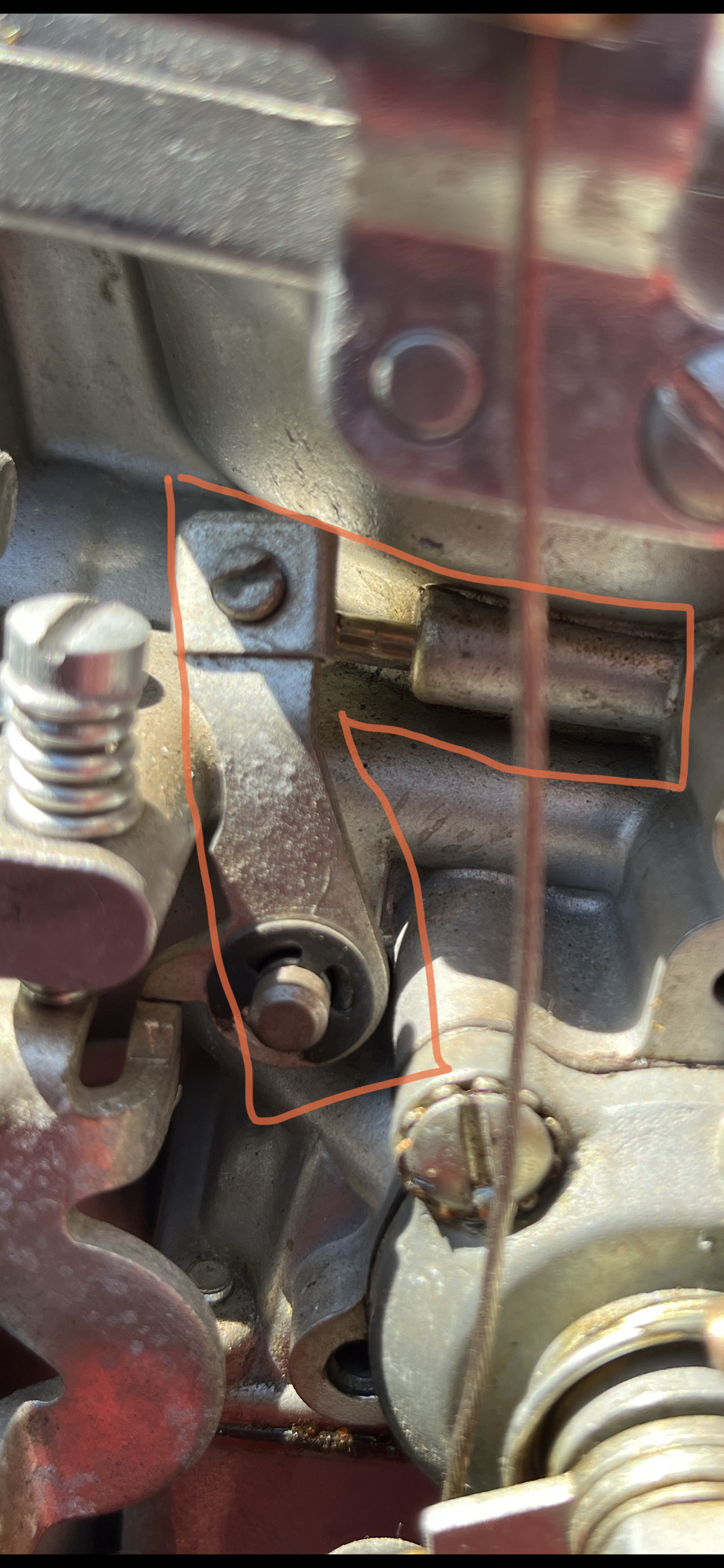

While on the subject… I can’t figure out what this is… I have 3 carbs and one has a very sticky little piston and one has that adjustment screw backed out all the way. Thoughts?

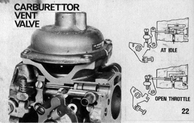

That's the type of transition valve for the float chamber vents that was found on the carbs for the 73 and 73 only carbs...Devised to make use of the Anti-Run on-Valve.
The system was greatly improved in 74 and retained thru the end of production of the carbureted TR6's

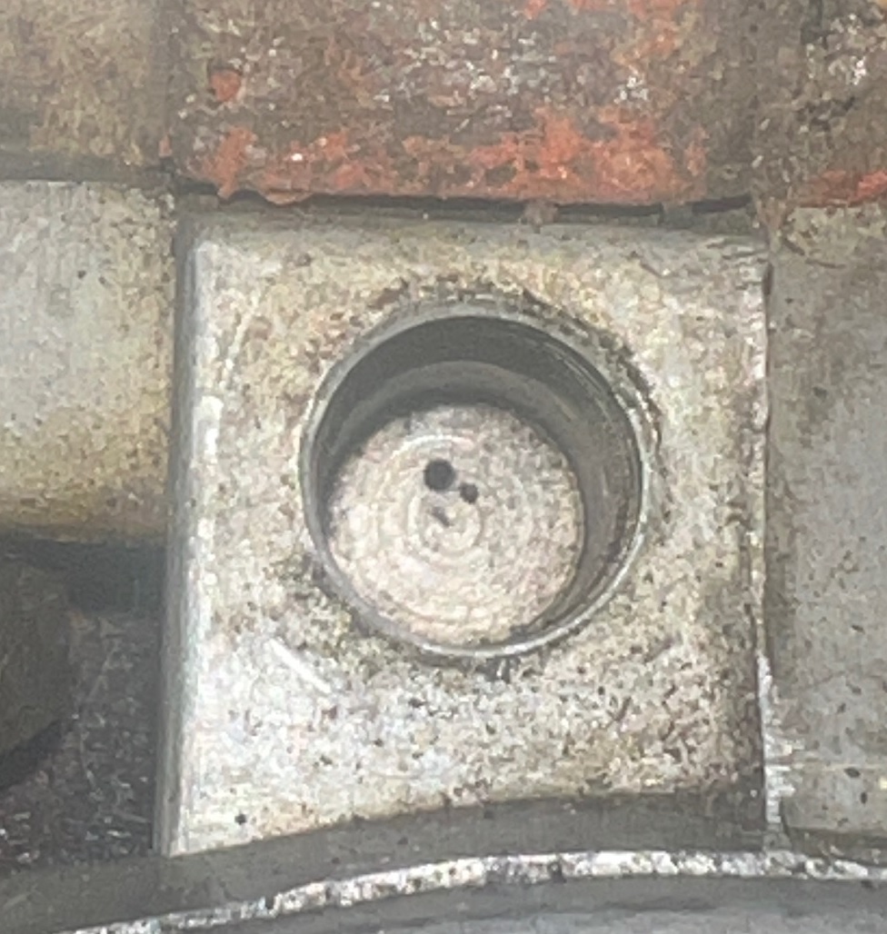

I'm working on swapping out to vacuum advance, have the same question. I'm assuming that this is correctly drilled through.
Take a look at where the hole comes out in the carb's throat when the throttle disc is in the idle position.
This should help:
Thats exactly what I needed, thank you! I held a light up to the inlet and could see the light through the port with the throttle closed, and not with it open. So I'm good to go.
