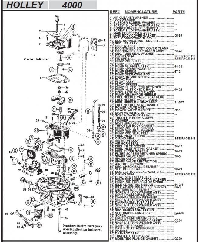

I think some of the seals are cork, and may have just dried out, so you might wait a couple days and see if they 'heal themselves.' If not, I'd say do it yourself, unless something is seriously worn (like the throttle shafts/bushings). I've heard nothing but good about Curto, but he's likely backlogged and you may be without your car for a while. The costlier kits come with more parts, like jet needles which you may or may not need. And, be thankful Healey didn't use Holley 4000s:
