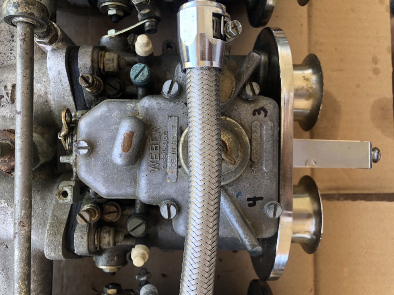

I have had the whole manifold & carbs off for cleaning…..
Those are the Spanish version, produced after emissions standards were enacted. Bit more fiddly but the principles are the same.
The cover on the #3 accelerator jet looks a bit crusty! Is its O-ring perhaps leaking?
...and I don't see the choke cable on that carb.
Wow. Those need a good cleaning IMHO. Would move the petrol hose for easier access to the tubes.

My picture isn’t the best, and may be before I cleaned up the carbs, but I only cleaned the outside of them…. I’m too scared to take them apart - the car runs well as it is…
Better pictures to follow!
Rocky
