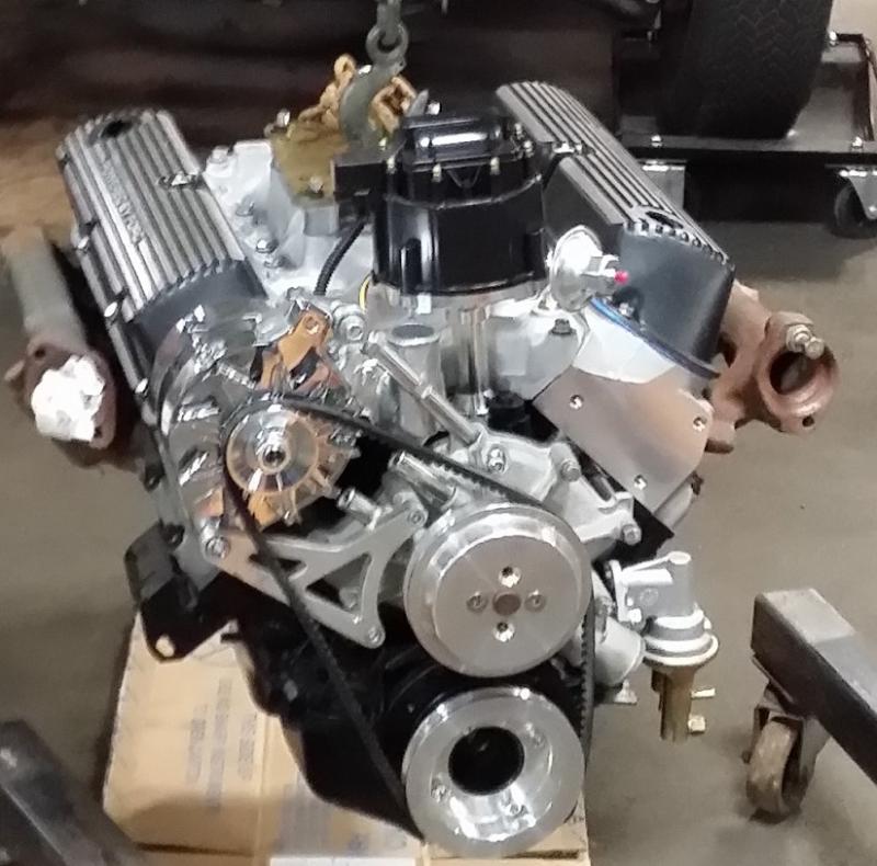

Greeting fellow TVR forum members... Happen to notice not much going on in TVR forum land and I'm pretty sure behind the scenes things are happening..
Sooo... I thought I'd post activity related to the restoration \ V8 conversion for my 71 Vixen..

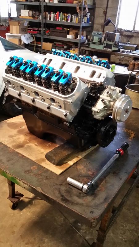

Its going slow but progressing.. The V8 (Ford 302 roller) has been rebuilt (aluminum heads - its my understanding the 302 with these heads weighs 60 lbs less than the original 6 cylinder)..

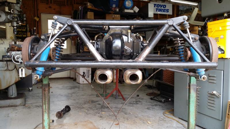

Currently the chassis is at Bent fabrications for some mods (engine and differential (Jaguar Xj12) mounts)... Tim has also fabricated the headers too..

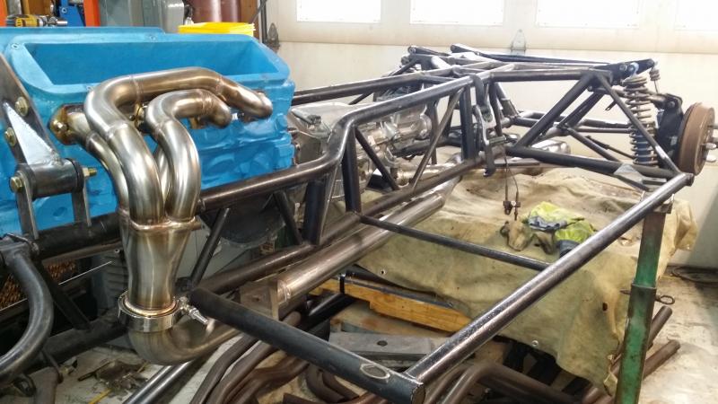

Hey Grantura_MKI... Yes, using this method opens up the bottom some for additional clearance... Feedback from Tim Chiles of Bent Fabrications - common for off-road tube chassis...
I've also seen where these are available for backside of the heads.

A Tiger friend of mine did the same front mounts to get header clearance and I thought it was a great idea. It is a tight fit on a TVR so keep up the good work and keep posting photos and info about these rare cars! Eric

Under racing conditions this my work. But as a road car, the heads are not the best for hanging motor mounts.
I do like to see early cars under there original motor.

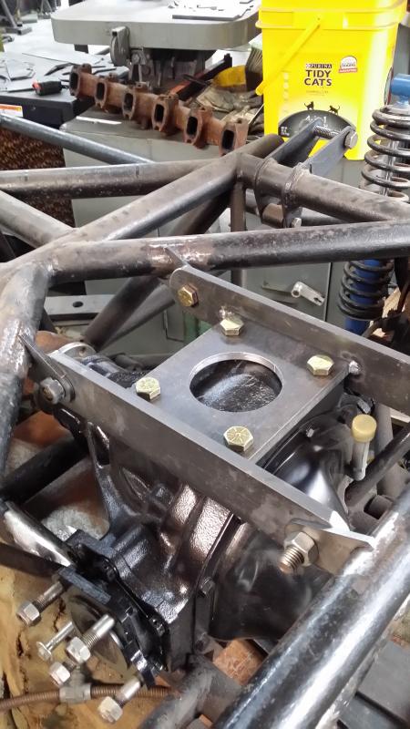

I stopped by the shop today (Bent Fabrications) to drop off the engine... Tim has the differential mounts in position.. (I was incorrect previously... its an XJ6 diff not XJ12)..

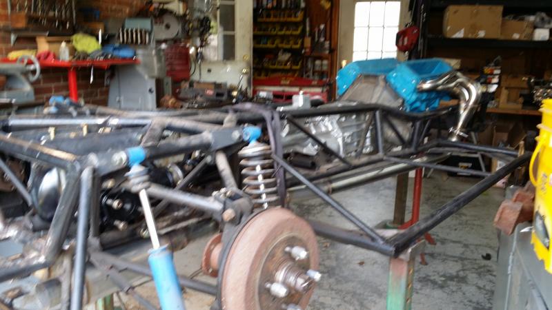

The engine - Originally the plan was to use stock exhaust manifolds reversed (sides swapped).. Come out top front and down under.. Now the plan is to use custom headers..

Pretty awesome looking engine. It looks like you're doing the conversion right. Many of them are unsuccessful if not dangerous. Everything has to be beefed up and the differential ratio has to be lower numerically. I had an MG TD conversion that kept the original 5.125 differential. The motor raced and the car went nowhere.
Hey PDPLOT.. oh yeah for sure.. don't want anything even near dangerous!

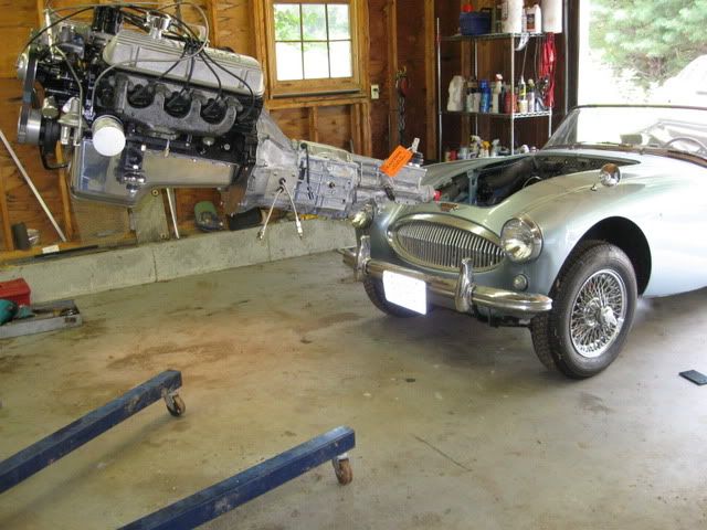

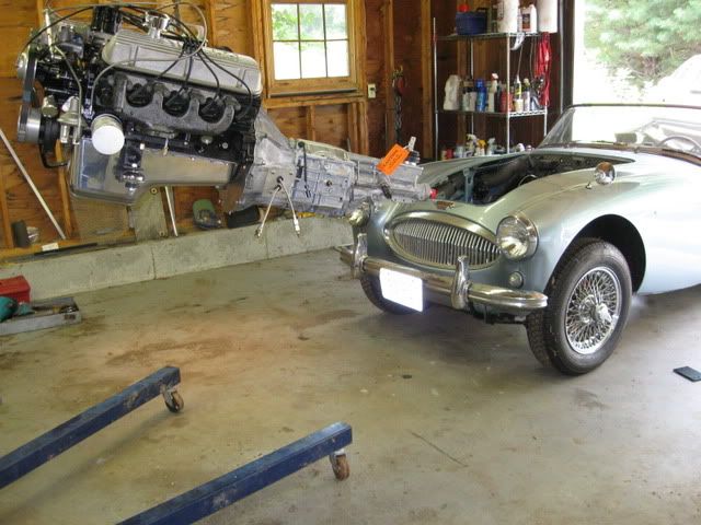

That's some nice header fabrication. I ended up with some Sunbeam Tiger manifolds to get enough clearance in my Healey. I'm sure you'll see a big horsepower gain over those log manifolds.

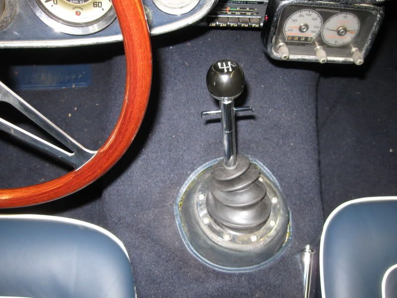

Wow... really nice looking HealeyRick! Is that Tremec transmission? I have a standard 5 speed and bought a White lightning street rod edition shifter to move it up... Else I would have had to go with a Cobra style shifter.. Would have liked to source a Tremec but the budget needed to go for higher priority items..
I see you were able to keep the oil filter positioned on the block.. not sure I can.. we'll see...

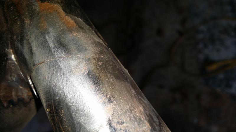

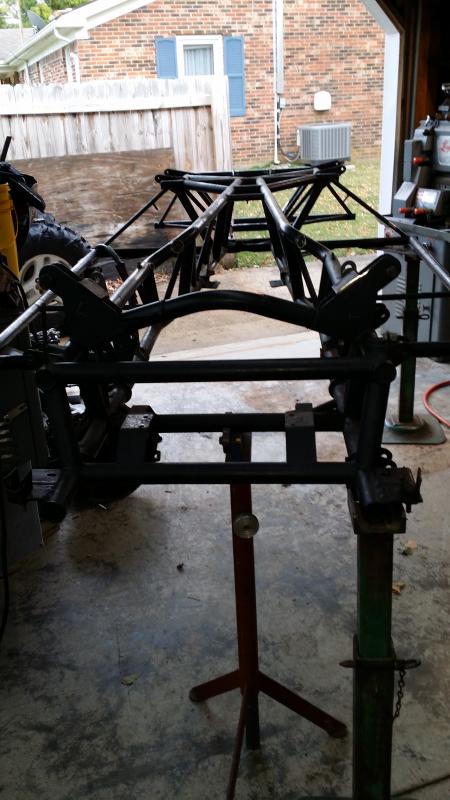

Stopped by the shop today... removed all remaining parts off the chassis. Getting ready to send it out for media blasting (plastic).. We really want to get it down to bare metal to inspect for any issues (already found one crack that will need to be repaired)..

It named a Salisbury diff.
oh yeah.. for what ever its called its got to take on what I believe the TR6 diff would have had a difficult time doing.. :rolleye:

The Tremec is a Ford Motorsport T5Z that I bought new. When I set the motor and transmission in the car, I placed it so the shift lever would come out of the original location in the tunnel. Fortunately, it all worked out from there. It has a Tri-ax shifter with a 289 Cobra-style shift lever.
