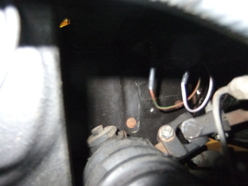

I did establish this evening the problem is (at minimum) the rack moving. I jacked up the front and could see the rack rock (at least the very small part of it I could see where the steering column is connected)as I moved the driver front wheel. It is definitely not well secured.
Problem is I can't see the whole rack, how or where it's attached. My '77 has a fan shroud up there that seems to enclose the rack and I can't see how to get it off. I'll have to pull the hood and take a more detailed look.
Any advice, anyone?
