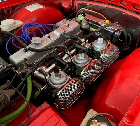

Not sure if you're still using points in your ignition, but I have triple CDs ZS, and had similar performance issues. It was my points. Give that a look before you lose your mind on the fuel system.
I thought that was the case. Would be sure that the blue hose is sufficient for the vacuum load and will not collapse.

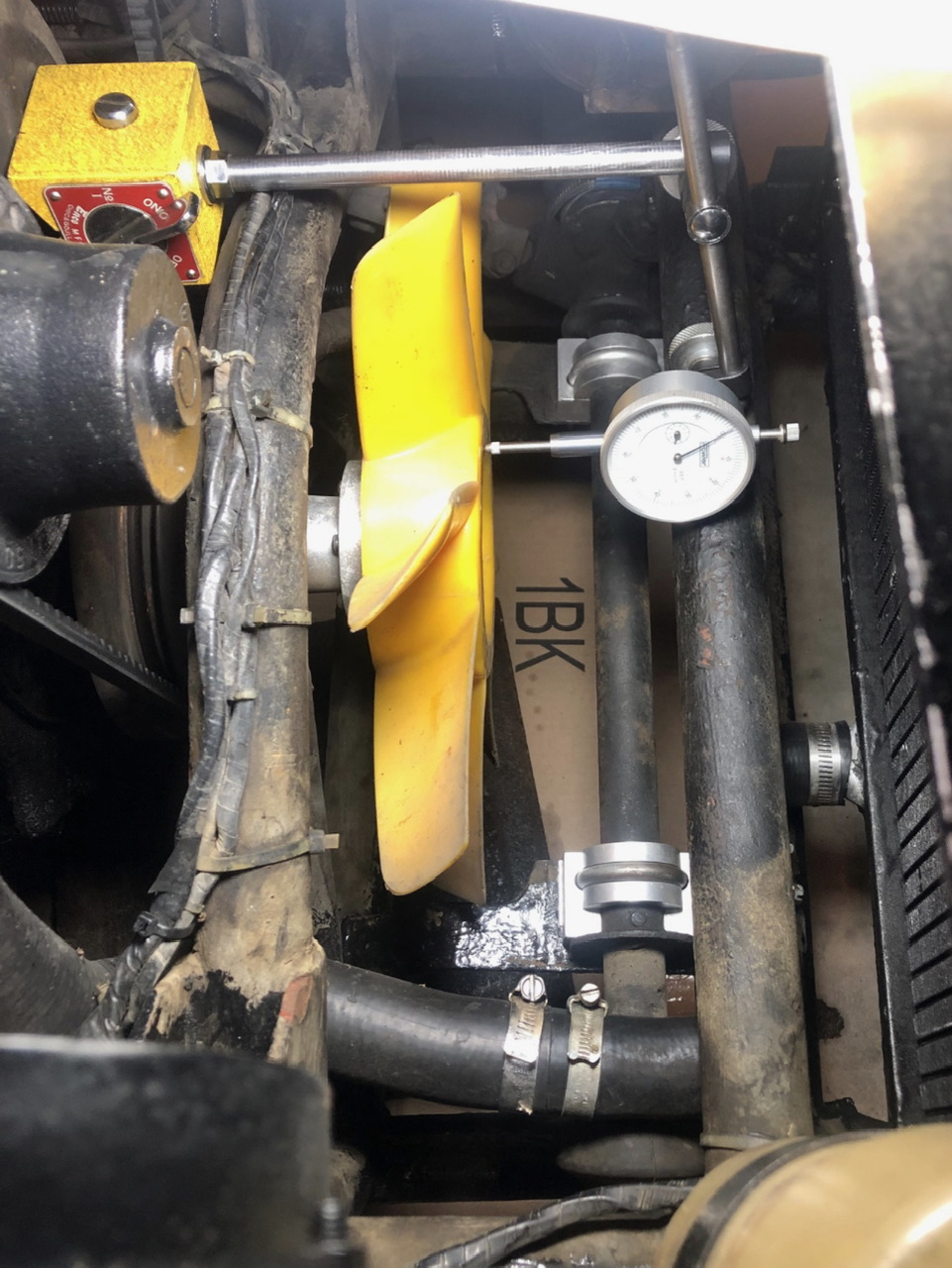

Also got around to checking the crank thrust clearance, which I happily measured at .010”, not in spec (.006 - .008”) but good for a few years of happy motoring!

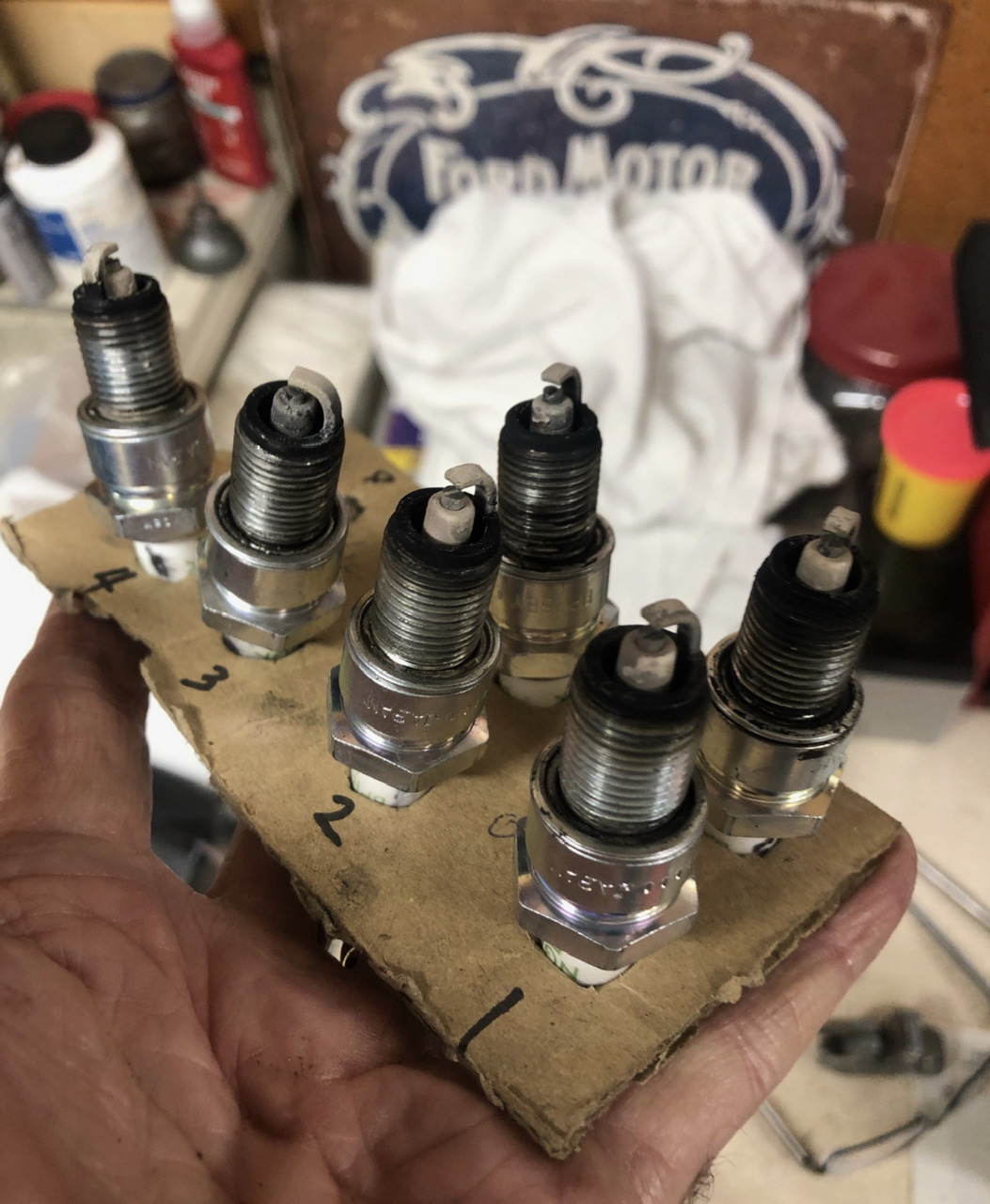

I have the triple ZS setup, and experienced similar issues. Look at your spark plugs after a good long drive. This will tell a good story about lean or rich mixture. Also, with those carbs, I wonder if there's enough push of fuel. Are you using a mechanical fuel pump? Although that logic would seem to give you an opposite effect, where not enough fuel at higher rpm. Also, a vacuum leak in the system, accelerator shafts seals, etc... I had this issue where the alignment of the three carbs were slightly uneven, and when tightening the shaft coupling introduced enough of a force that caused seal leakage, making a lean mix. If you still have points, you can NEVER rule out bad contacts. I've been bitten there as well.
