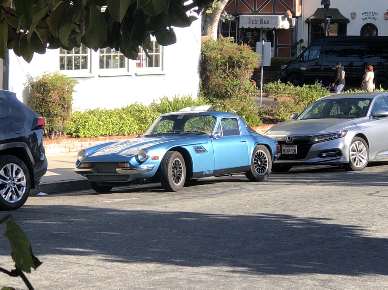

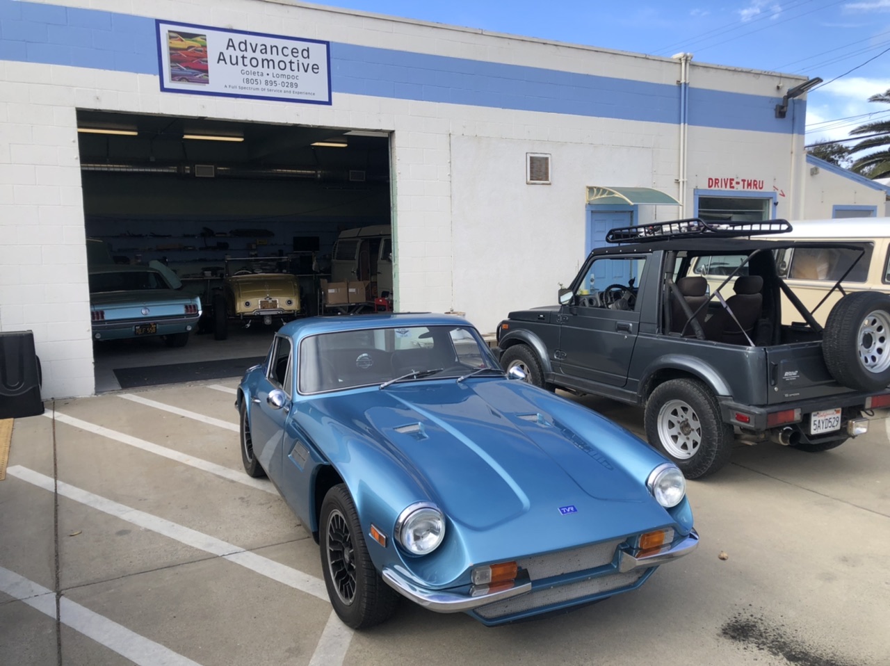

Rocky_LC
Out and about!
Tybalt
Everything still going along relatively smooth? Glad to see that you're getting the TVR out and about, there's a guy that lives within a few miles of me as near as I can tell with a blue TVR 2500M and I see him out and about in it on occasion.
Platinum
Looks great, glad to learn it's running well!
