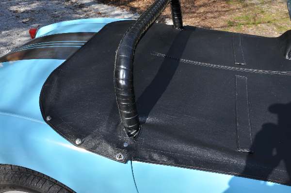

Gundy
My top and tonneau have these swivel things. They twist and lock
the "critical" edge of the covers. You can see one in this pic.
Is this what you are referring to? Notice it is turned 90 degrees and rests in notch in the cover piece.

My 62 Mk II has the same swivel fastner and it's used to lock down the front corner of both the top and tonneau. Fastened to the body with rivets originally.

Aha! That's it!!
Thanks guys, now if someone has a close up of the fastener on the top or the tonneau that would be priceless! :wink:
I imagine it's a slot that the swivel part fits into.
Platinum
escutcheon fitting, hole is contoured to fit on the base of the "swivel thingie". Again: check boat supply places.
