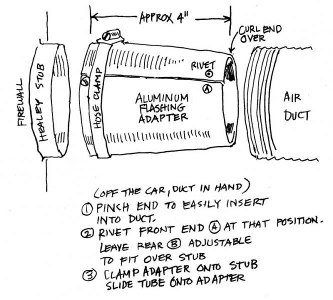

I have seen a metal reducer that Bill Rawles made ( a bit like the Steveg one but without the taper) and that fits into a smaller duct then that clamps over the stub on the fire wall - seems to work I suppose that you would have to do the same at the other end - I did not notice that bit.

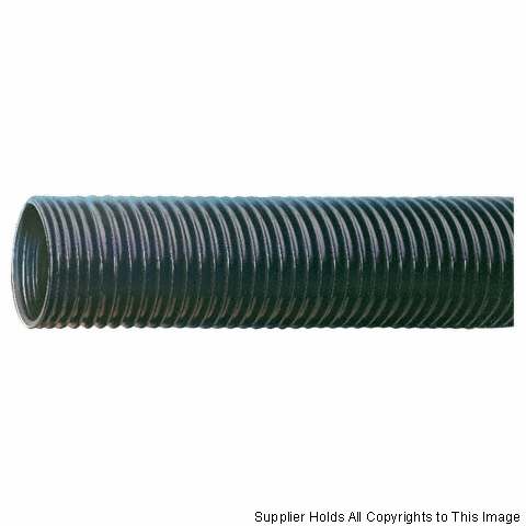

Dayco makes a 4" duct hose #80175. It is a heavy black rubber hose, flexible, with a coiled wire support. A Parts store that sells Dayco should be able to order it for you.

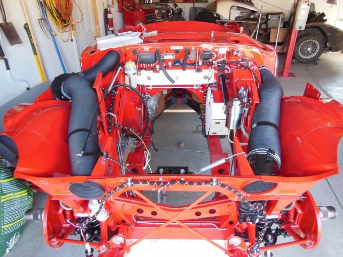

I did both my cars with the body off during restoration. I used the original type material as I want the car to look like a car not an appliance using dryer venting .

I also installed mine when I had the shroud and fenders off. Unfortunately I had to unattanch the hose to get the fender bolts on and then reattach afterwards. It was a bit easier the second time.
