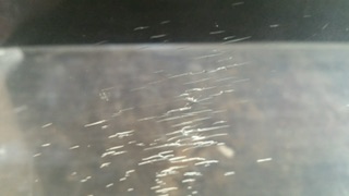

TR2/3/3A Removing scratches and scrapes fro the wind wings that screw to the windshield?
