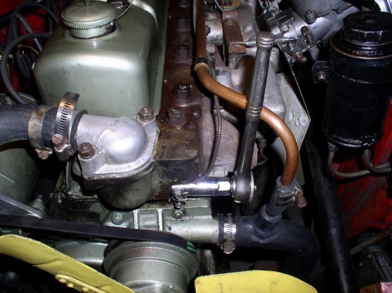

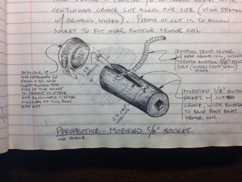

This works great on mine...but I'd be careful as to how much you rotate on the racket with each turn. Don't want to damage the coiled line.
Also, I found that pulling gently on the coiled part of the line enough where it meets at the hex nut helped to ease any further stress when rotating the rachet (spanner).
My design allows rotating the nut 1/6 turn at a time, removing and reinserting the socket then fastening, unfastening the hose clamp each time as I went. My advice if doing this is to go slow and be ginger as you go.

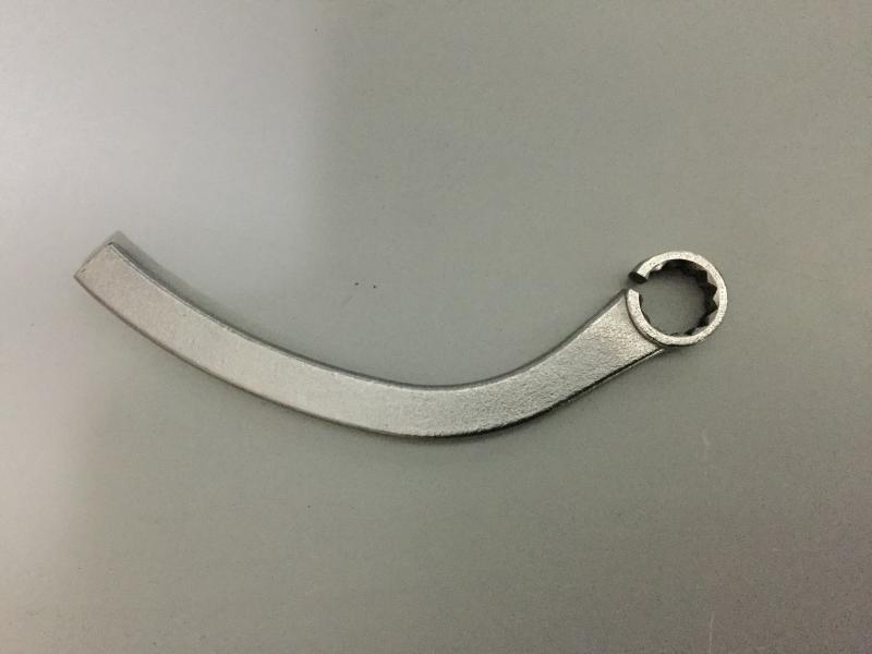

Another option is to use a spanner/wrench and cut it down with a slot in the ring end. I used a 5/8 “u” shaped wrench from the local hardware store which I cut down as in the picture. This way I had enough length to get purchase and the curve shape allows me to use it without removing the fan, radiator, or any hoses.
The slot is just enough to let the coil wire squeeze through. I then pull or push so the ring is essentially “compressing” the slot rather than expanding it. I have used it many times over the past 20 years and it has never failed to work regardless of how “stuck” or corroded the probe may be.
