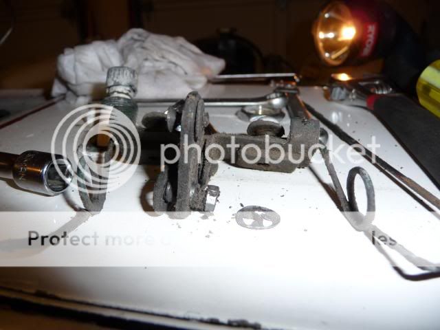

M_Pied_Lourd
Here is a photo of the mechanism ...

Let me try to describe the drawing I made: A 1/4" dia. X 5/16" long brass rod. With a # 36 drill, drill the length of the rod and tap with a 6-32 NF tap. Next , drill a 1/8" hole cross-wise in the center. Your rod goes thru the 1/8" hole and you need a 6-32X1/4 HEX HEAD screw to grip the rod. Hex head is a lot easier to tighten than a slot and screw driver arrangement. on the other end of the tapped hole put another short screw, good only as a means of keeping the bugger installed on the fork. Any help? Le
