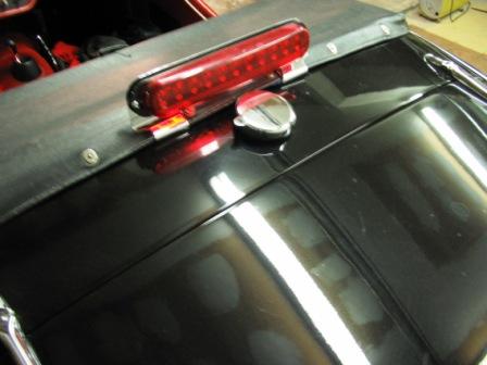

I designed and built my own third high light for my 1958 TR3A. I drilled the securing holes up under the rear flap of the tonneau cover. The extra screws are also hidden by the flap of my soft-top roof or my stick cover. I paid $25.00 for the LED strip at a flea market and the position of the light permits me to re-fuel the tank because the new light does not intertfere with the gas filler cap.
I put the light high where it can be more easily seen by the sleepy semi-trailer driver who is sitting in traffic behind me and so he will see me and not drive up onto the back of my TR like I heard happened to a TR6 owner.
BTW, I can remove the whole assembly in about a minute if I am showing my TR in the judged concours at VTR or TRA.
