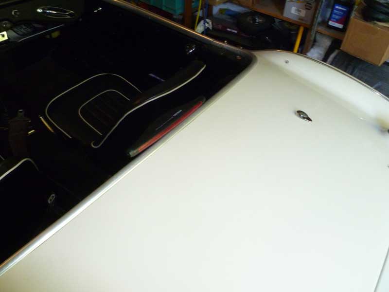

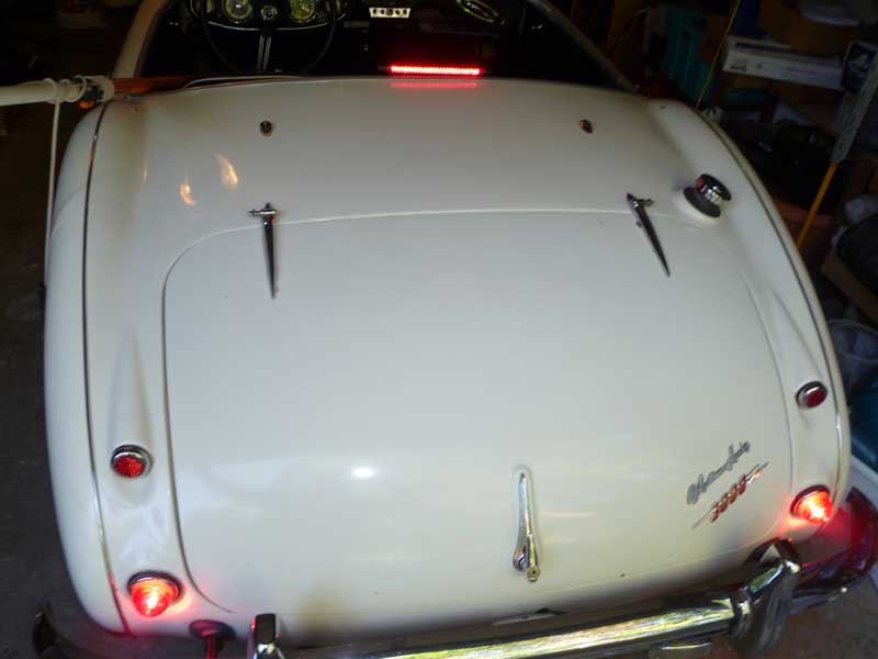

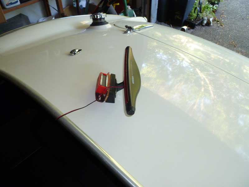

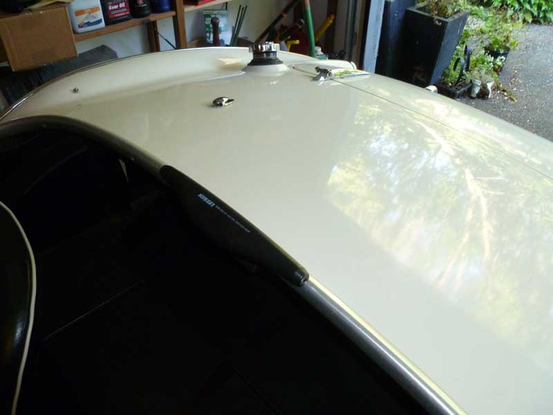

Here are some photos of what I did on our bn7.
I wanted something that could be easily moved out of the way, so we could still use the tonneau cover.
I bought the light on Ebay (nothing special) and the magnet at Home Depot. I think the magnet cost more than the light!
It sticks firmly to the steel brace under the shroud.
Greg
