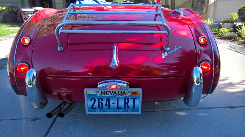

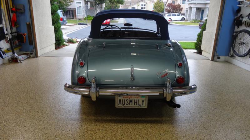

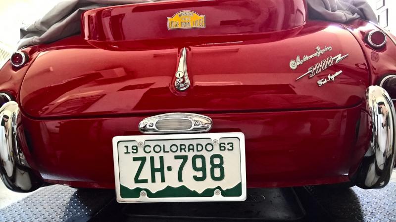

What I did was use the Lucas license plate light from a Jag. XK140, it has a built in back up light. I rewired the backup light as my 3rd brake light (actually 5th since both of my reflectors are converted to brake/turn lights). Then I got a high intensity red led to replace the light in the Lucas unit. So, looks period correct but adds a bit more light when braking. Of course, it isn't a high mount so that's a negative... but at least it's more light! Sorry for the poor quality pic...AH 3rd brake light Small 50.jpg
Cheers,
Steve
Rick,

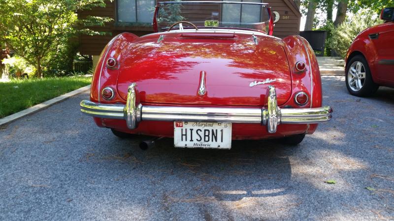

I did the same 5 light treatment on my son's BN6 ....
Lucas license plate/back up light used on Jag. XK140, repurposed as another brake light with LED... also reflector conversion to brake/turn signals from BCS.... actuated by mechanical brake switch set to turn on brake lights at the slightest touch of the brakes.

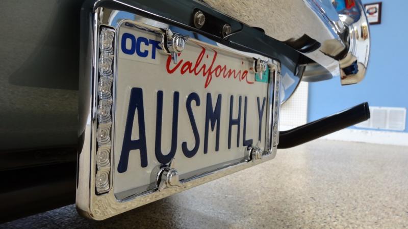

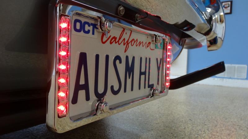

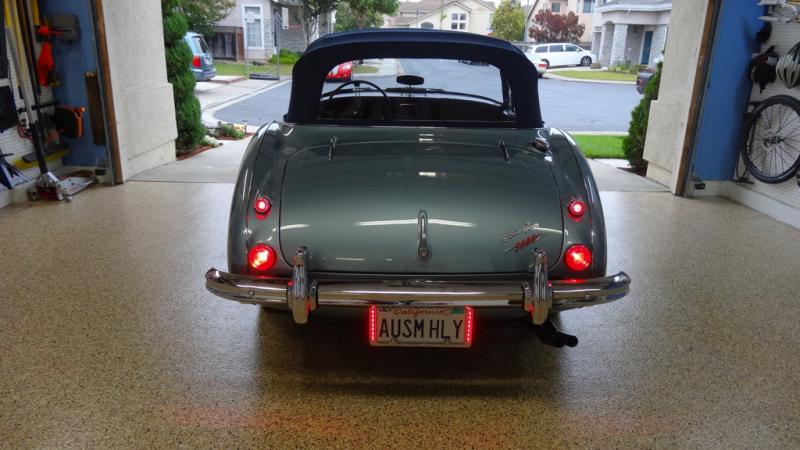

I did the same thing as you. I Modified the reflectors, using a mechanical break switch and have the "3rd" break light near the license plate.
I'm in the camp that doesn't want to drill holes or modify the car in a way that shows I've modified it. Whenever I add (modify) something, I try and do it in a way that the car still looks stock.
I modified the reflectors to light up as directionals and as breaklights. I added a license plate frame that has a roll of clear led's on the left and right of the frame. They blend into the chrome frame, so unless someone points them out to you, they're not noticeable . When powered they light up red. When I press on the break pedel I have 6 sets of red lights. The idea is more red lights at the rear of the car the better.
Those who say, the 3rd break light needs to be higher to be seen, I'd say your a tailgater. We should always be at least one car length behind the car in front of us. At that distance you can clearly see the license plate and also under the rear of the car.
