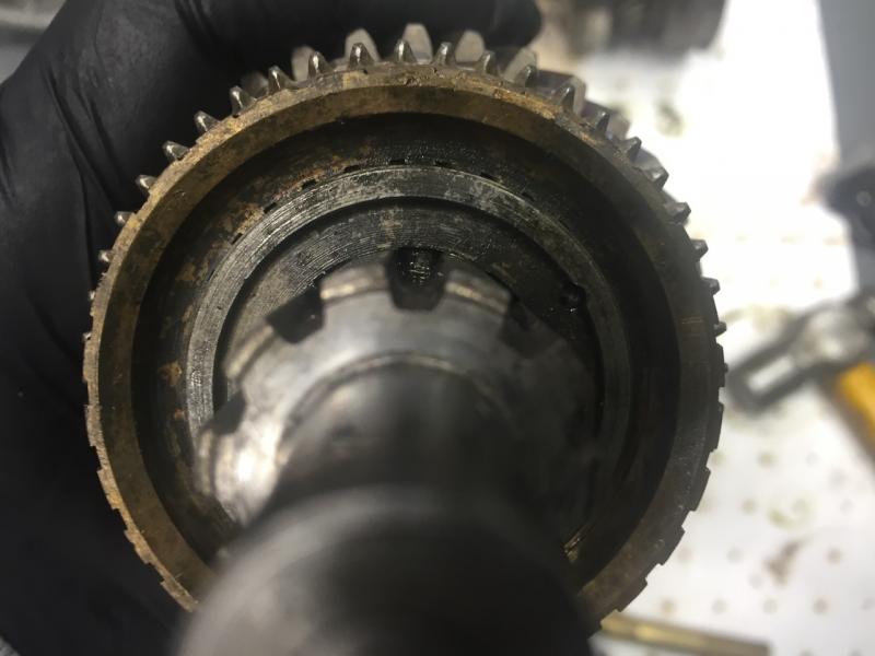

I have the third motion shaft out of the BN1 3 speed and the first thing in the directions is to remove the splined lock washer. The directions say to depress the spring loaded steel plunger, which locates the splined washer at the forward end of the third motion shaft, and turn the washer into line with the splines of the shaft.
