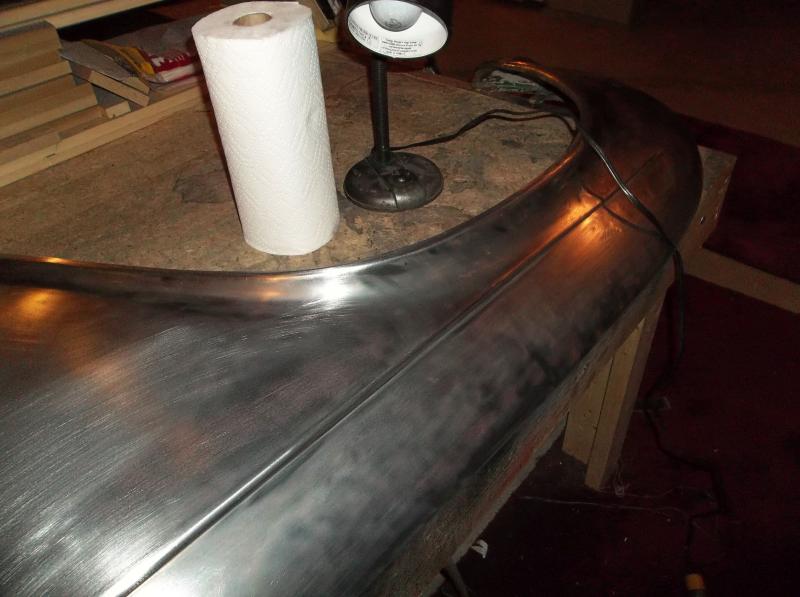

Vila
If I had the money to buy the equipment I would go with the soda blasting.
I used a 4 1/2 inch angle grinder with a 4 inch knot-type wire cup brush that I got for $7.99 each at: https://www.wdcart.com/cremos/catalog2/index.php?main_page=product_info&cPath=61&products_id=182
They took off the paint, primer, bondo, undercoating, and rust.
Keep moving so you don't build up any heat. Just like sand blasting the heat will warp sheet metal parts.
