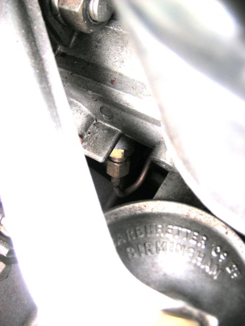

2) The bottom of the rear carb just outboard of the throttle plate and about 8 o'clock. Here's a picture if it works
Marv J

Thanks y'all for the info ! I knew the brass tube had to connect somewhere
and reading the repair manual did not help much. Something about "the carb
communicating with the distributor"? The Healey is running fine now so be
interested in seeing how it runs when I hook everything back up.
