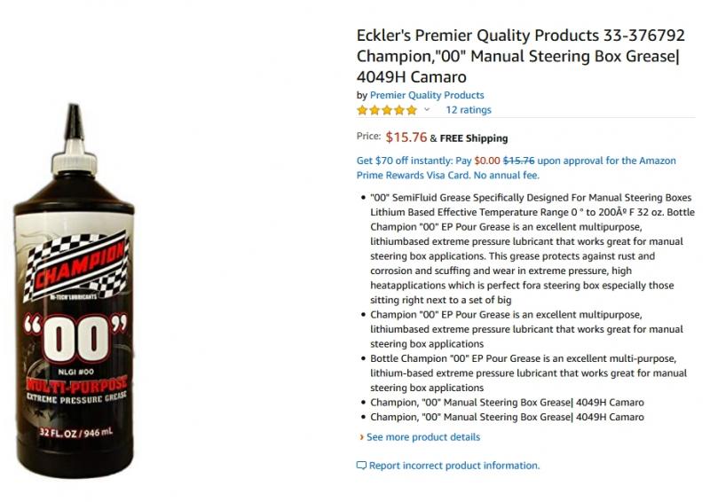

Penrite Steering Box Grease is a NGLI grade 00 grease. NGLI grades are like SAE oil grades for viscosity, except for greases. Normal chassis grease is NGLI grade 2. Corn head grease is NGLI grade 0. The higher the number the more viscous, all the way to grade 7, which is a hard wax. Amazon has some NGLI 00: https://www.amazon.com/s?k=nlgi+00+...410855&tag=googhydr-20&ref=pd_sl_413okb9lbb_e I've seen the Champion before, but I'm still working on my bottle of Penrite.

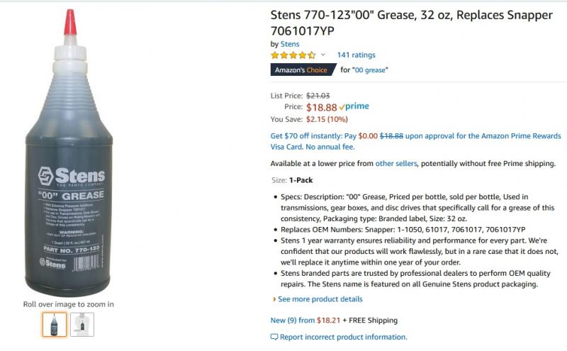

I'm currently using this. Same viscosity as Penrite and the Moss product. Since I had the cover off my box so many times a couple of years ago, I did like Richard and filled it with the top off.

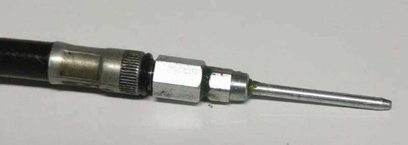

I rebuilt the steering box on my 62 BT7 and used Corn Head grease form the local John Deere dealer. You should be able to get a needle type grease fitting part for your grease gun and pump it in through the top as others have said.
