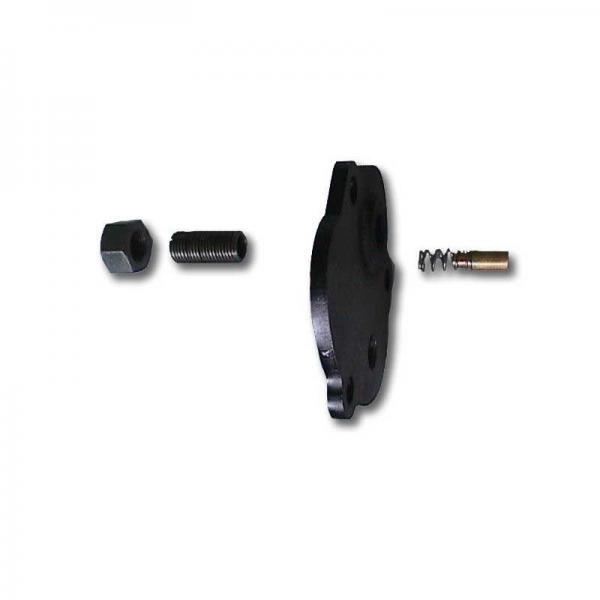

TR2-3B RHD Improved, spring loaded steering box top cover.
This cover incorporates a spring-loaded pin, which keeps the rocker pin firmly in contact with the scroll, thus removing unwanted 'slop' from the steering. This plate can also be used on some AC models for Left and Right hand drive, particularly Aceca and Ace

We have had at least a couple threads discussing the spring loaded top plate. I don't remember any consensus being reached, though. Several have used it and love it. Others have used it and don't like it. It likely has to do with how far worn your box is before you install it.
I suspect there is more to it as well.
A friend of mine had it installed on his 3A, and it was so bad that I advised him (upon being asked) to take it back off. The problem is that the spring will compress if you try to actually corner hard; which gives even more play than the stock cover. You just don't notice, because you're turning against one side. So the play becomes more like lost motion; except then if you speed up or slow down, the spring moves and the steering changes without moving the wheel. Proper adjustment will likely minimize that (his was so bad that we could see the Pitman arm moving up and down during low speed parking lot maneuvers); but the bottom line is that the free play isn't gone, just hidden.
So IMO it also depends on whether feeling no play at all is more important to you than having the car actually go where you point it.
Even with the badly worn worm on my previous TR3A, I was never tempted. (Herman van den Akker used to sell them too; but quit.) Once you accept that it steers like a TR3 (rather than say, a Miata), the stock steering really isn't all that bad. Just different.

I had one of Herman's and it seemed to help and work okay on what I think was a slightly worn box. But then it failed completely (possibly the spring broke, anyway the pin was stuck at the full-in position) and I was unable to get any support from Herman to find out how to disassemble the set-up or if they were prone to jamming.
Unfortunately the top cover itself is modified to make these so returning to original required procuring a new top cover.

Unfortunately for me, Herman required my original one as a core for the modification he would do -- otherwise yes, it would have been simple enough to swap it back on.
Looks like the Revington version at least lets you keep the original part.
I believe this is a bit different then Herman's. As I recall it was a bit taller and looked like a threaded rod coupler was welded to the top cover with a spring and a brass plunger that road on the top of the peg rocker shaft. If anyone has a pic of Herman's that would be great. Hear is a side view of the part.

Herman's may be similar, this is it:
The pin is now jammed fully in:
I could not get it to release. The top cover has an enlarged threaded hole for the spring-loaded adjustor, so I made a new (fixed) adjustor from a suitable bolt and jam nut.
