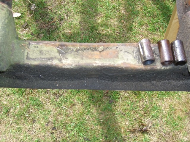

sp53
Got them off – on the first one I chiseled a ditch to see how deep to grind them then after the ditch, I ground that off and dug another ditch and ground that off. When I went back to chiseling, it moved and I wiggled and pipe wrenched it off. The next one I ground down and using the flat spot from the grinding I chiseled the flat spot down and it moved. Anyway if you look at the picture you can see that on the frame there is a damaged spot from someone hitting it with a hammer. The spot will not show much with the engine in, but I would like to fix the appearance. There is a piece on the bottom of the brace, so pounding it out from the back will not work. I can either just leave it or bondo it up, but if someone has a clever idea that would be nice. I have another frame where that piece is perfect and the rest of the frame trash so that is an option, but again I am perhaps over doing it.
CJD
Cutting it and replacing the section would be the perfect method...and take a perfectly incredible amount of time.
I would just use a little filler and forget about it.
