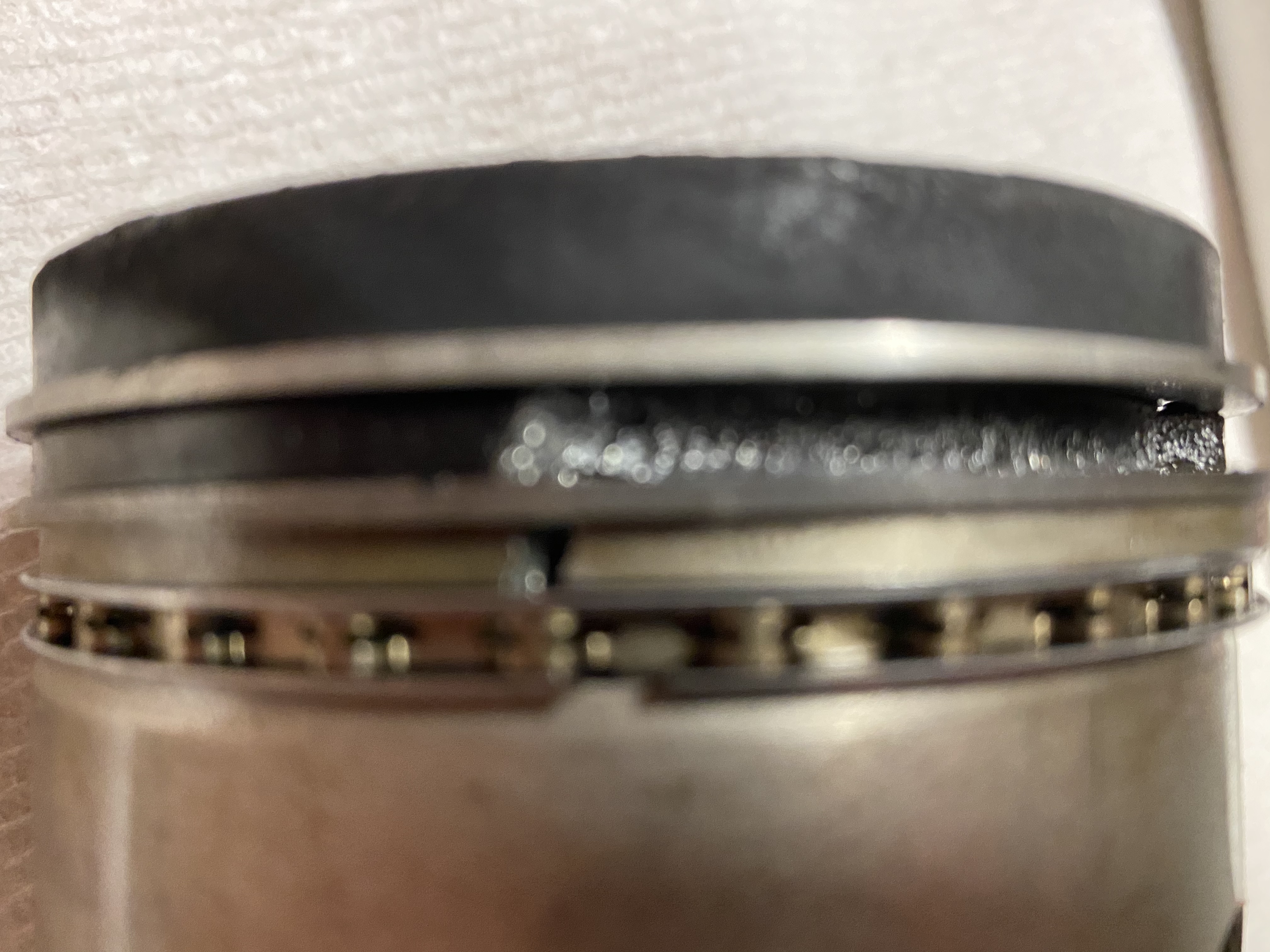

I’ve put a minimal number of miles on this fully rebuilt engine but had a piston failure.
#4 piston self destructed. The piston collapsed at one point breaking the first two ring groves.
I did a compression test showing 175# on 1,2,3 and 120# on 4. Pulled head off and removed cylinders.
I looked for replacements but found all sources to be back ordered. This sounds like a recall. Anyone have any insight on this?

Bummer. The most common cause of that would be detonation. Of course a flaw in the piston and mechanical interference are also possibilities. One thing, 175psi sounds rather high to me for a compression test on these engines. It sounds like you have a higher compression ratio than stock, which can be a good thing...unless it promotes detonation.

Today, normally I would look for detonation issues but I saw no distortion to the surface. It was heavily carboned but nothing else
CJD
Interesting. I see a crack going down below the second ring too. I would lean towards a flaw in the piston. How does the carbon-free area look? Is it dull or shiny? Shiny may be a sign that there was contact with the head. Also, were the liners new or re-conditioned?

Dull
Appeared to be new.

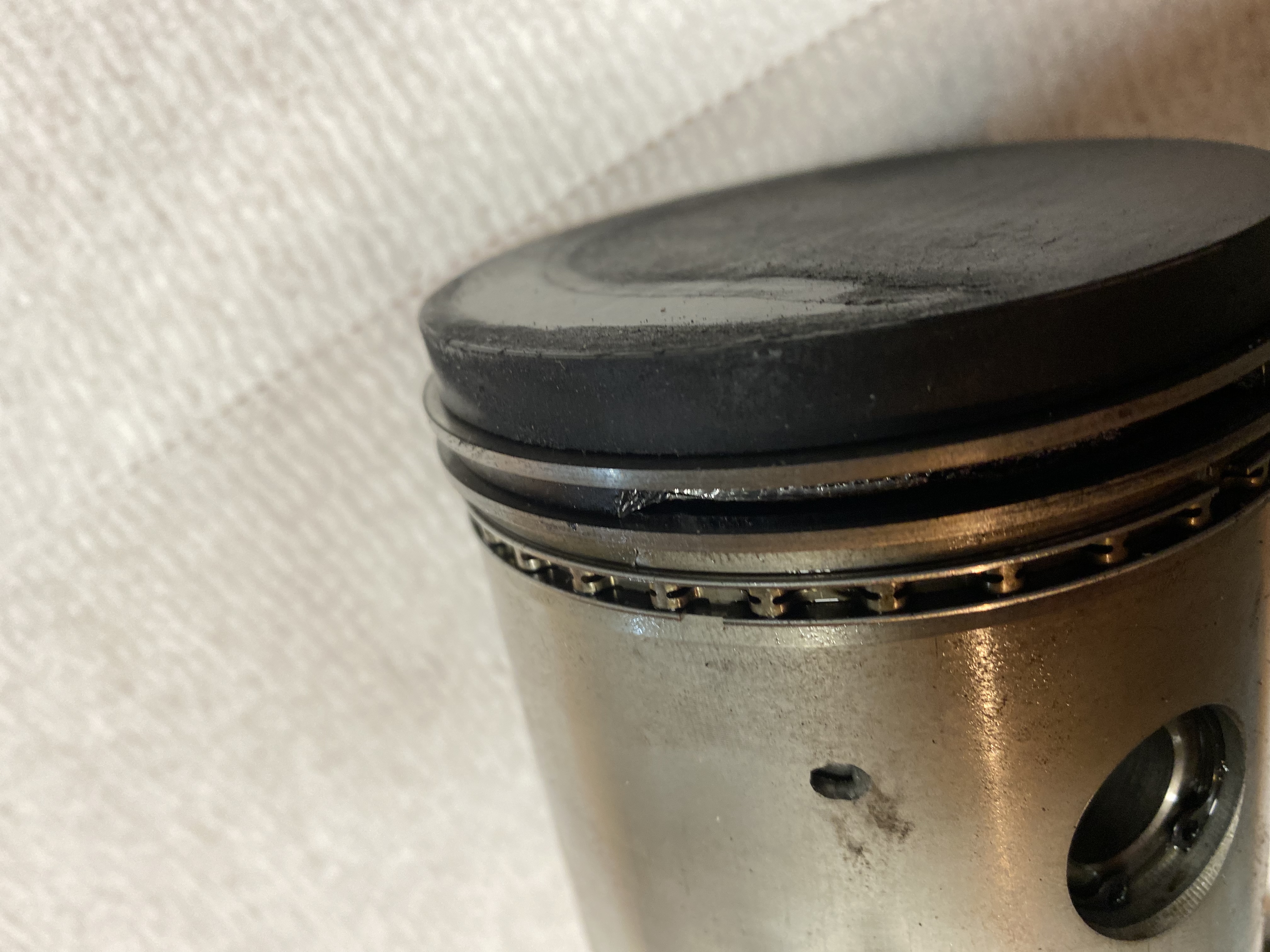

Is that a hole in the piston almost level with the
Is that a hole in the piston almost level with the gudgeon pin hole?
David
pin hole? It looks like it but i've sent them back to the supplier and have to rely on an old man's memory and the photos. The wrist pin was checked and no excessive movement. Since I looked at the piston and my attention to the piston failure at the power ring and below, I did not take notice of that hole. Good pick up on your part but I feel the uniformity suggest a manufactured hole and not a new one. Since it is well below the rings, if it was a hole it would only assist oiling the cylinder wall??? sorry I over looked this.

Zooming in on that hole it does not look like it was drilled more like the piston wall was knocked out from the inside. Rough surface and a cone shaped hole. Also just below the hole the piston wall looks like there is a casting defect.

I can’t argue your observations and agree with the hole nir being drilled. Seems that would have eaten up the sleeve wall; #4 sleeve would have only needed a light touch with a hone. I wonder what failed first the side where the hole is or above in the r rings, chicken or egg.
