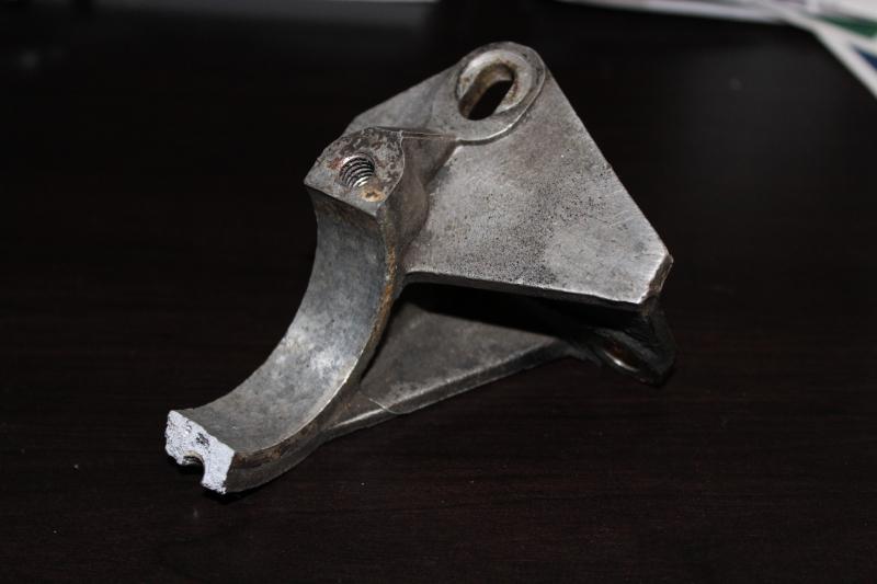

HELP !!! I was feeling so proud of myself on progress today in installing front suspension, steering column, and remembered I need to tighten rack clamps. Got the torque wrench out and got to 20 lbs on PS Rack Bracket when I heard a very loud SNAP and the steering rack mount aluminum bracket snapped in half. I was using the original bolt and it appears the bolt bottomed out and the mount simply snapped.
MOSS does not sell this part. Anyone got a spare or know of a source for this part.
Also, There is a backing plate that goes behind this bracket. AH Spares catalog says two brackets are required. When I pulled apart only one was installed. IIRC only 1 bracket is needed and it goes on the side opposite the rack. AH Spares does sell that bracket.
So either a source for new or anyone got a spare on a parts car from a BE, Mark II or III. My hope of getting to a 10/26 show in Tampa a are dependent on finding one of these Clamps for PS. Thanks Team.

I have both DS and PS brackets (still bolted to my spare rack).
Cost of shipping. Should fit is USPS Overnight box. Let me know
I see the spacer in the AK spares catalog, part 46. They call for two per car. I also only have one on the PSA side. I do not remember ever taking the rack off my BE, so it may be factory.

Oh and the spacer, I'm sure it is based on how the body went together. Sometimes it would call for one spacer and sometimes one on both sides to keep the rack squared up is my best explanation.

Also, remember that torque specs are with a moving bolt/nut. If static your numbers are way off.

New/Slightly used steering rack brackets installed today. Torqued to 10-12 lbs. Good to go. Engine install team will be here at 1:00 Sunday to give me a hand with install. All bolts located, all parts needed for engine install on hand. Oops need new Driveshaft bolts and locknuts. One more trip to Ace Hardware.
