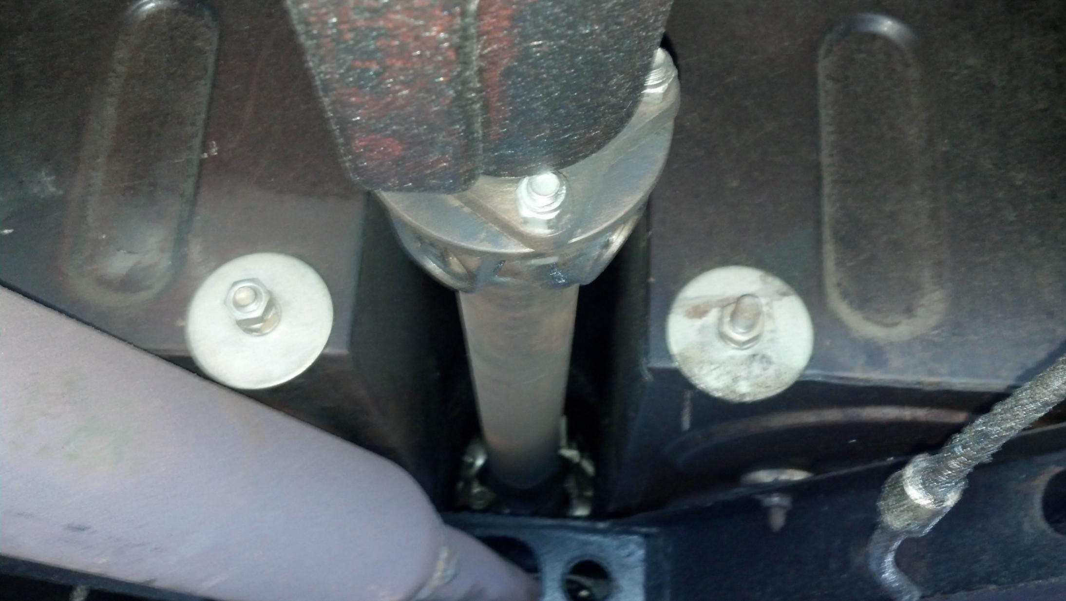

I don't know about your car but mine had re-inforced mounting points on the front of the wheel wells and holes on either side of the drive shaft housing just aft of the OD. I re-enforced these with the large heavy washers that came with the seat belt kit.
Good luck, Dick

Here's a picture I found showing the interior mounting points for each side on a TR3. This is looking from the rear towards the front. The outside mounting points are on the outer part of each "box" behind the seats, about 10" out from the interior mounting points, as I recall.
Hope this helps,
Bill
