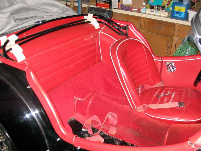

After you look at the photos in the links above showing how I welded in the nuts for the seat belts in the green TR3A, here is a photo of the seat belts in my own black TR3A.

When I purchased my 3 last spring, the dealer wanted to add competition belts so I could join him racing, but I did not have that in my plans, so I just went with lap belts. They are easy to hide at a show to make the car look closer to stock, and still give a slight bit of protection from ejections.
