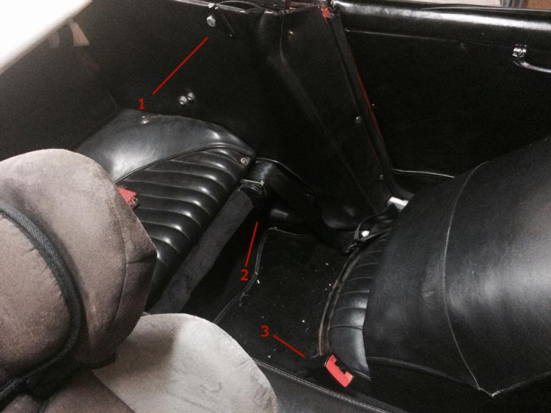

Hi,
When I got the car, last week, it had these kind of seat belts installed. But the shoulder guide is attached on the side interior (1). This seems a bit strange, or? I mean the side interior trim cant hold a crash's weight. What do I do to correct this? What are the correct seat belt anchor points located?
Or am I missing something?
Does anyone have pictures on their 3 point belt installation?
/Danne

#1 in your first photo, those two bolts to the right of #1 are for the seat belt.

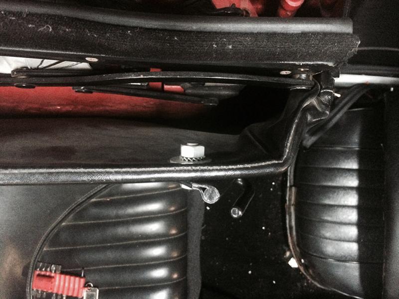

Do not use the bolt in the 2nd photo. That panel is made of thin wood and can not take any force.
Ok! I thought those two bolts were for back seat belts. But if I put the belt in those (that would be a non-retractable belt I guess) I will still get a bit weird angle on the belt, since it's going over my shoulder. Should it be any guide holding the belt, for the shoulder?

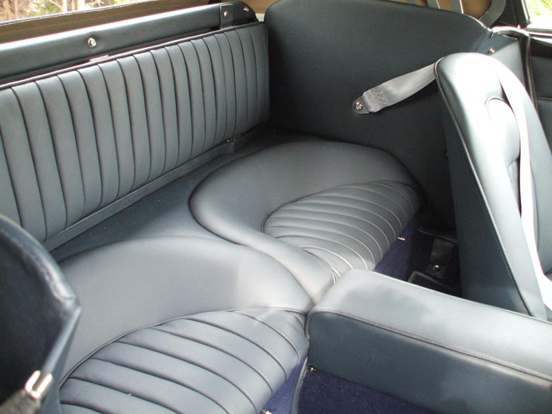

Original style were not retractable. Original did not have a guide for the shoulder.
People who have installed retractable ones hopefully will post with where and how installed. Maybe some photos too.

Like this ,-)
Okay, I don't claim to be an automotive safety engineer so take what I'm saying with all due caution. But I wonder how unsafe the shoulder harness guide location really is? The retracting belt mechanism is actually mounted by the floor (#2 in your picture) and the only thing the guide does is keep the belt from slipping off your shoulder. My 3-point belts are mounted at the standard mounting point (the two bolts mentioned by AUSMHLY) and my belt does slip off my shoulder. What would happen in your car in the event of a crash? I suspect the guide would tear from the panel, but the belt would still remain anchored to the floor.

HealeyRick, yes if I don't misunderstand you point out exactly what is wrong with my seat belt installation. It's no good. In the event of a crash I suspect my shoulder is going to be pressed downwards. My back will be compressed. So I think I have to do like on Keokes picture (like you also have I guess), non-retractable belts. If it slips off it's still better than my installation. The angle of the belt seems much better. It won't cause the same "compression" I reckon. Or what do you think?

Biggreen, that is a non-retractable belt on your picture, right?
