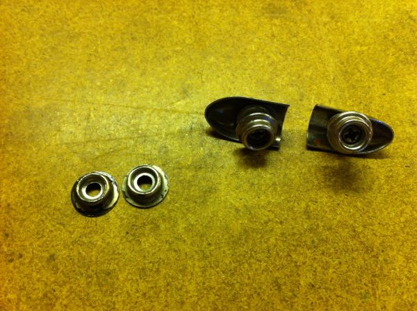

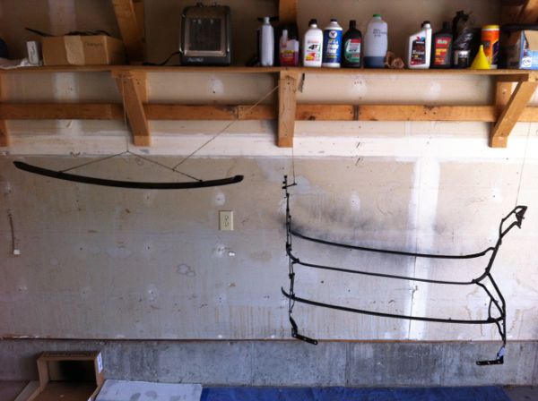

A local club member gave me a later style folding frame, and I spent some time cleaning it up and put on a fresh coat of paint tonight. The header rail had some surface rusting but no holes and was otherwise reusable -- latches are in decent shape too. All it was missing was one of the snaps.
As I was cleaning up the garage tonight I remember that I still had the old scissor frame... and it had snaps on it. So I now have the proper riveted snaps and some spare screw in snaps (replacements of some sort that were on the scissor frame). Good to go! New Robbins top came in today, seals and some assorted nuts and bolts due in on Thursday. Moving right along!

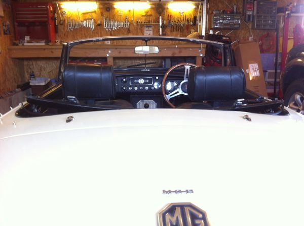

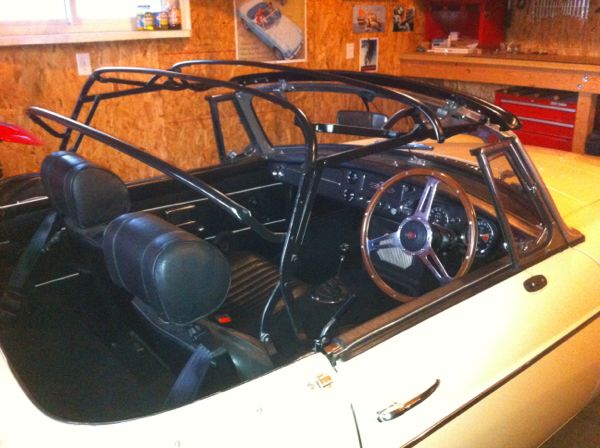

Made a bit of progress today on the new top frame. Received the last few pieces I needed today and got the frame assembled and attached to the car. Scrounged a few pieces off my old frame, and even had an excuse to purchase a new tool (pop rivet gun).
Will be calling my upholstery guy in the morning to get it scheduled for fitting. Hope to have it all ready before my trip down to Moab in a few weeks.
