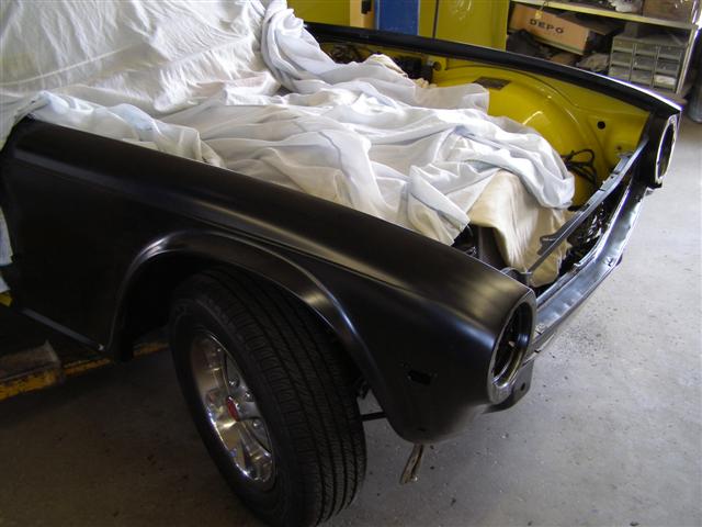

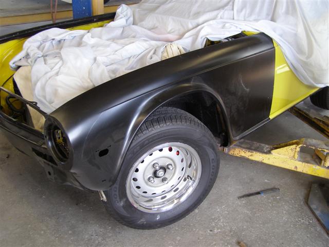

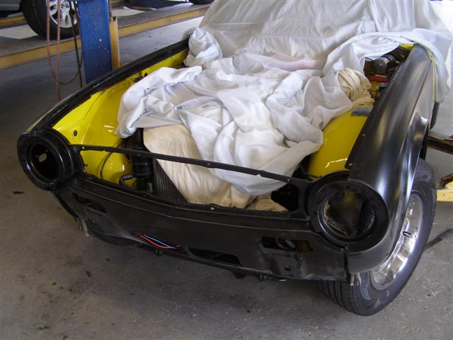

Well, it ain't quite pretty (yet), but it is a lot of progress from 3 weeks ago. Today started the panel fitting and adjusting before changing body mounts and final alignment. Then it will all come apart for painting before reassembly.

I got lucky and those are early British Heritage panels. The hood and fenders were the last of the old stock that they had. The front panel is also British Heritage and it is as heavy as the original with undercoating on it.

I think that it will be as good as, or better than new. I'm glad that I went for the right front fender now. There was a small hole, about the size of a 50 cent piece about midway along the bottom. The undercoating was hiding it.
Luckily (again) there was not rust damage inside the fender and the rocker panels and quarter panels are rust free.
Alan is very fussy, so I trust his work and the fact that he really likes the car and takes pride in what he's doing with it. So if it takes a little longer, who cares? It will be better for it.

The Heritage panels look good and should be a good base for the work. As a note to others that are drooling over those pieces - it appears that there are some differences between the front valances on early cars and the Heritage valance. I bought a Heritage front valance and found that the holes for the turn signals are about 3/4" lower than they were on my original valance (on a 1971). I suspect that there was a change to the valance on the home market cars (probably in the 1974 range) and that is the basis for the Heritage panels. With the higher bumper of the early cars, lowering the turn signals 3/4" will cause them to hit the bumper. A later bumper like the early '74 won't have this problem.
