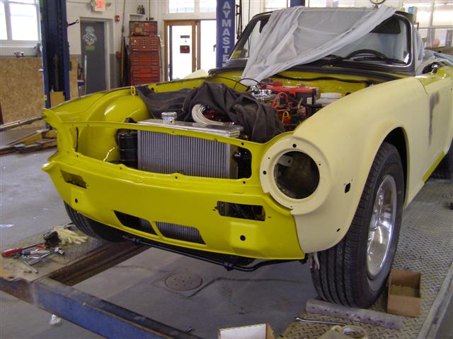

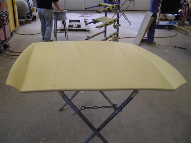

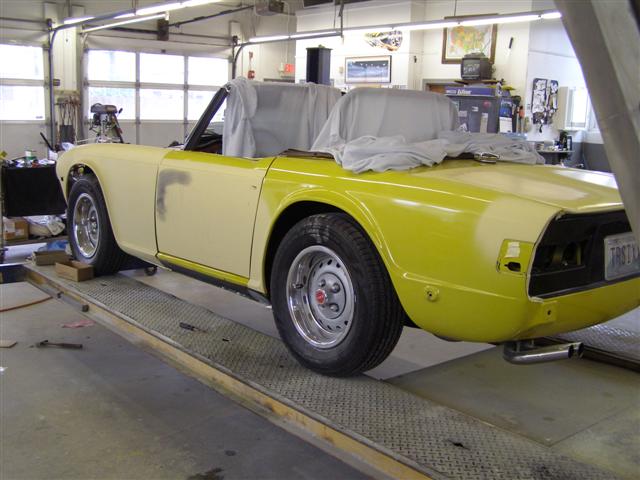

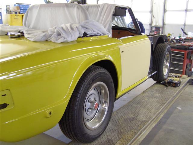

So far, so good. Getting the major stuff done and getting ready for painting. The front panel was prepainted, cleared on the back and is ready for welding in place today or Monday.

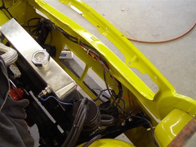

The fenders are pretty much pre-fit and all of the powder coated bumper braces are on and the wiring has been run.

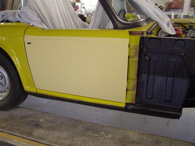

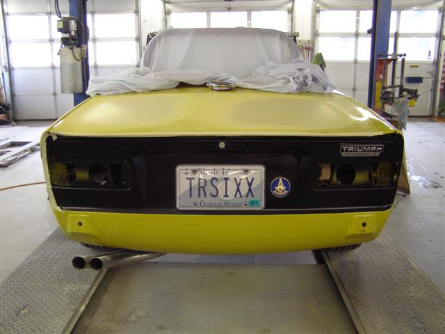

Both doors have the parking lot dings and my wife's battle scars between the grass rake and the deck lid has finally been healed.

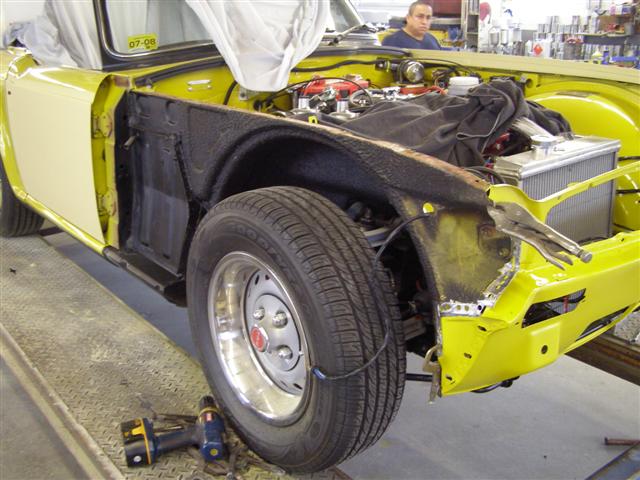

Oh yeah, the inner fenders were cleaned and painted with two coats POR15 and the drain outlets from a 1966 Mustang 1/4 panels that I ordered from CA are on the way. More to follow on that drainage issue next week.

It looks like you got the radiator cap with the built in temp gauge?
Bobby,
Mr. Gasket radiator cap, with pressure gauge. Kinda neat!

Looking real good. Could you talk a little more, or give a link to the drainage outlets you mention? I will be redoing baffles at some point on the TR4 and am looking for options.
Randy

He did the hood three years ago and is aware of the mirror look in the polished radiator shroud. Any mistakes show up twice with that thing installed.

I'm going to install the rubber slotted one way drain vents that were used on the early Mustang quarter panels as a shield to run the line from the hose shown in pictures #1 & #2 to the inner splash shield, high enough above the tire spray to negate any possible water coming in.
I should have them early next week for a better look and posting of what we are going to do. https://www.americanpony.com/store.mv?p=597200
Paul-
Hadn't seen those before, I definitely would appreciate a photo of the installation. I don't like the other option often used of routing through the sill, mine are in questionable shape already.
Randy

I just checked with Mustangs Plus in CA and my little drain project rubber parts are due here on the 1st, so I post a separate thread for that.
