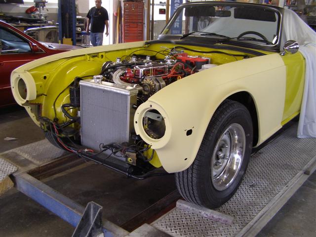

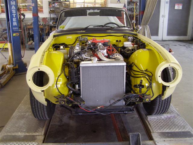

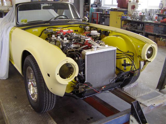

Today the frame checking and alignment was completed and the fenders were primed and set back in place. Tomorrow the front panel will probably be welded in place and the panel alignment and fitting will continue.
The hood is being stripped and prepped for the epoxy primer just like the fenders. I'm hoping that the bumper will be done by weeks end so that I can have it for the shop to make sure all of the final fitting is right before the fenders get any top coat on the inside.

Pretty sweet Paul, looks like she's in good hands.
And on a lighter note.. is it me or when the grill is off do our cars resemble a 63 Dodge Dart? I'm thinking maybe.

I learned something today! I did`nt know that the "Front Panel" (I guess you mean the grill area) was welded. Since I`ve never had the need to dis-mantle the `72 TR6 I had; I thought they were bolted to the fenders, DUH.
Paul, With the all Alum. Rad, Do you still mount an Air Duct in there?
Do the "Trip SUs" really perform as good as they look? What sort of difference do you physically feel from the Orig. 2 Carb set-up?

You can't see them all that well in the photo, but the same wheel covers as on the Dart were used -- with appropriate 'text' changes -- on the 1969 model year US Spitfires, just as the ubiquitous 'Air-Flow' wheel covers on so many Heralds and early Spitfires were adapted from a Plymouth Valiant wheel cover (again, without the Plymouth-specific logo)!

Russ, there has been much debate about triple ZS carbs versus twin ZS or SU carbs and FI, MC carbs, etc., so let me keep it short and sweet. Without major engine work, such as compression and cam, as well as headers, ignition and the lighter flywheel, I truly believe that they were a waste of money and time. In that order, only because the time was spent learning a lot about the car, the money, once spent was gone.
HOWEVER, since I have done all of that work, when I push it to the floor now, it is MUCH more than a lot of noise from the carbs. My car always ran well and the trips helped a little, but to really get the most from them, you need additional engine work. But again, the dyno will tell the real tale and that probably won't happen until spring.
If I had it to do over again, I would do the engine modifications exactly the same way, but with the Mikinu motorcycle carbs.
But to be honest, I think that my car (current configuration) would run really well with slightly richened twin ZS carbs and low restriction K&N filters.
In other words, save your money.
Yes, I still use an air deflector (Goodparts polished aluminum) around the radiator. Must have equipment in my opinion.

Your very nice car looks to be coming along great, and from looking into the pics, the shop you chose also appears to be very well organized to handle this kin of repair!!
How do they plan on matching the colour,and will they be blending into the doors, or performing a complete??

<div class="ubbcode-block"><div class="ubbcode-header">Quote:]How do they plan on matching the colour,and will they be blending into the doors, or performing a complete??[/QUOTE]
Silver,
It will be a complete repaint. You can't see the rear of the car, but the tail lights are out and the bumper is already off. Once the front end is done and all of the body mounts are changed, they will align every panel, then the paint removal will begin.
The adjuster agreed that the match would never have the same exact texture or color, so to insure that didn't happen, it's getting a complete job.
