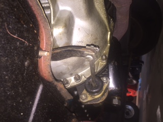

Thank you all for your quick responses. I do have several manuals both the Bentley and the Haynes TR6 manuals. I took a picture of the setup on my car and compared it to the manuals as suggested.
The one thing I noticed is that in the book the Clevis Pin is in the last (3rd) hole unlike the picture in the manual which has the Clevis Pin in the Second hole. Other than that there is no difference. I did notice that there is a sweating around the rubber seal on the Slave Cylinder. One of the manuals indicated that if the fluid happened to get low in the master cylinder that you should top it off and bleed the system. Sounds like a good first step.

Bleeding the clutch system is incredibly easy and only takes a few minutes start to finish. First park on a grade or raise the front of the car 3 or 4 inches. This will make sure all the air will evacuate from the slave. Block the rear wheels. Check the fluid level before starting and after every 4 or 5 pumps and top off when finished bleeding. Have an assistant pump the brakes while you lay on your back and reach under the car and work the bleeder valve. You don't have to even see the bleeder valve because you will easily hear the escaping air from the system.
And use the center hole for the clevis.
