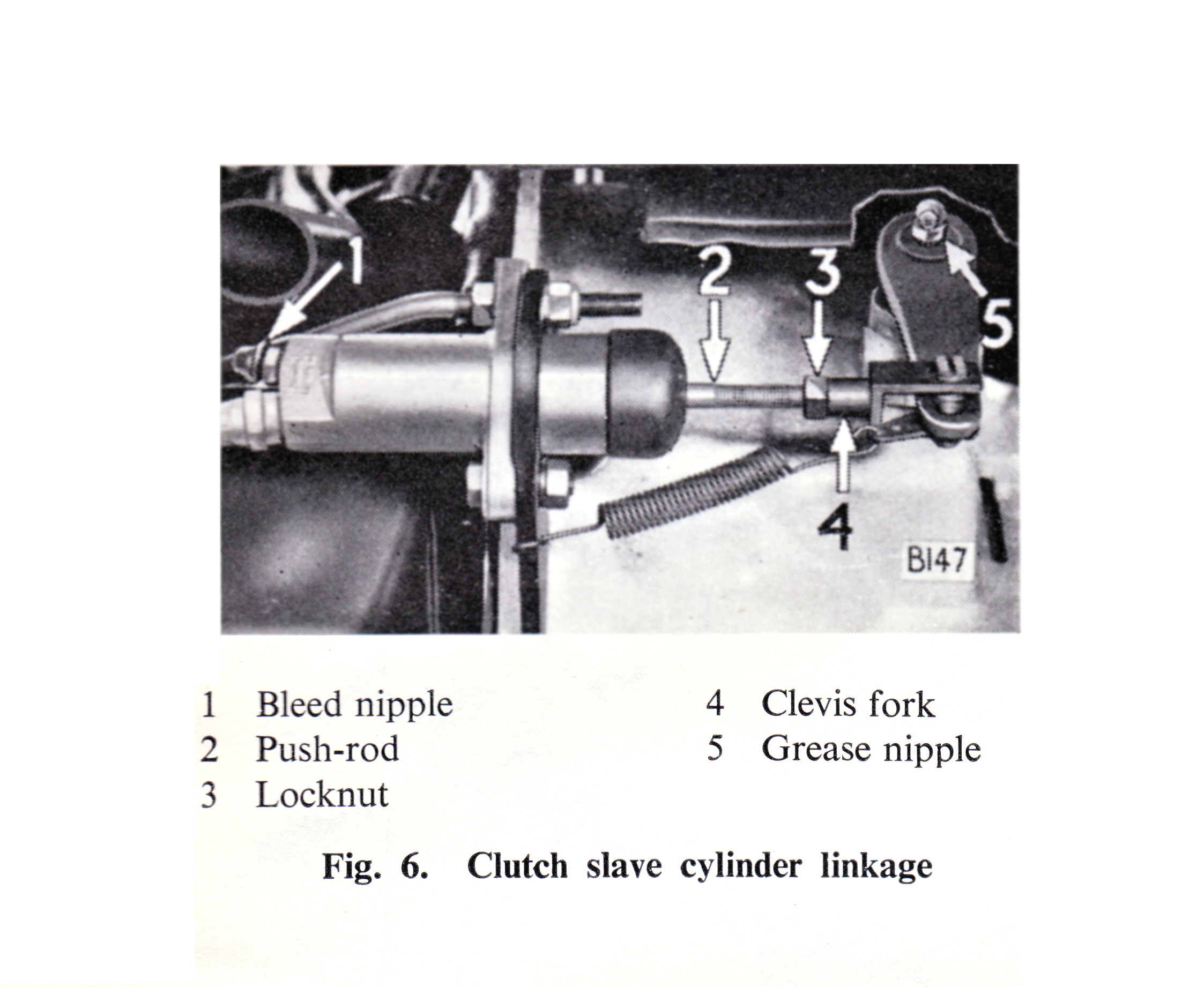

sp53
try this

sp53
I would unhook the spring then push the guts back in the slave to the end of the piston by hand and set assembly linkage with a very little play more like a slight click so that there is some play and then try that to see if the clutch works without the spring. If it does, hook the spring up and see if the spring stops the travel and the clutch from working. If it does, then try a different spring. Some cars do not have springs.
The adjustment on the clutch is like 1/8 of an inch of slop in a hydraulic system without pressure on the system ( kind of like a brake system just sitting there), and I believe the spring is there in hopes the hydraulic linkage system from its own weight does not push the rod onto the TOB and cause it to drag a tiny bit some, but again I think they drag some. At least that is what I think I hear when the car is in neutral and running. If the spring is wrong, it acts like a steel rod at some point and will not let the rod out.

Redoakboo
I was using the old spring and a hint in the Forum suggested I ntry the Spring that roadster Fac. sells for a Girling System; which I have. The new one was alot stronger then the old one.
