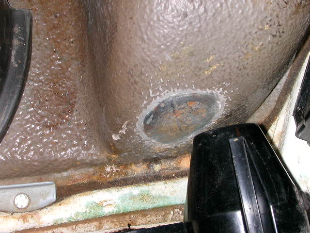

Anyone know anything about 911 fuel tanks? It apears I have some sort of corrosion at the front of the tank right next to the battery. It apears to be a soft bubble that has air, or possibly some fuel in it. It seems to be about the size of a silver dollar and I can push it in about a 1/4 inch, and then contact something hard. It feels as if the outer skin is just bubbling away.

I havn't had a chance to take the car to anyone who would know anything about this.
Here is a picture of what I'm dealing with. There doesnt seem to be any fumes in the trunk and the "bubble" seems to be intact and not broken.

That is decidedly not a good thing, John. Corrosion under the coating, looks like battery acid to me. You'd do best to "yank th' tank" and clean/repair it. It's going from the outside, in. May not be through ~yet~, but it will be. The tank ain't too hard to remove in one'a them things. Have you access to the *factory* books? That'll be the best reference.
I know, I know... $$$! But: Take 'em one at a time and "collect th' set" if you intend to keep the car. The electrical system one is invaluable.

Just today I went to the nearest Porsche service center/dealer (unfortunately without the car) and they said that if there is any type of damage or corrosion that their only fix would be a new tank. They said that they were unable to do any repairs to a tank other than a full replacement. Does that sound about right to you? It's pretty spendy, but a new tank that I put in may be cheaper in the long run than getting it repaired. I'm pretty sure it wouldn't be a cheap fix, and sounds like Porsche wouldn't "approve".
Platinum
Sounds right for a Porsche shop, sure. They can't make any money on tryin' to fix the existing tank. And the liability issue is part of the story, too.
As I said above, they ain't that hard to get out of the car. 6~8 bolts and some tubing, IIRC (not counting trim, carpet, draining the tank an' suchlike). A radiator shop may be an alternative to "The Dealer." Ask around, find an independent place and remove the tank yourself. I wouldn't say the word "Porsche" when describing the problem, either... /bcforum/images/%%GRAEMLIN_URL%%/wink.gif
A thought: If it were here, I'd be pulling the battery and all "soft" materials out of the way and doing a "biopsy" of the thing. If it's as I suspect (battery acid corrosion) and you get to it in time: i.e. if it hasn't yet gone through the tank, it'd be an attempt at cleaning & neutralising the corrosive then coating clean metal with a good undercoat material, tank in-situ.

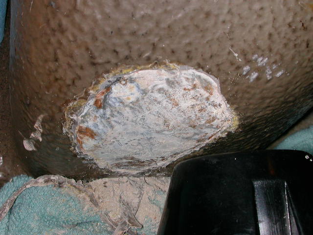

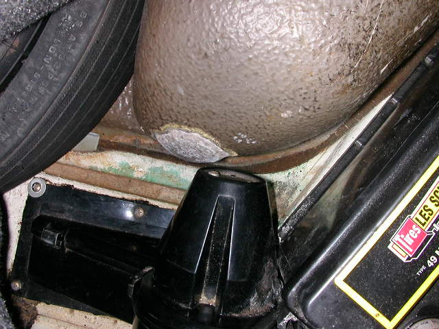

So after running the fuel down as low as I dared and mustering up enough courage, I took the scalpal and performed some surgury on the "bubble" on the fuel tank. To my surprise under the rubber coating was air and a ton of corrosion powder. I cleaned off what I could, neutralized it with the fancy foaming spray, and was surprised to see the metal in fairly nice shape. I tool a dremel tool with a wire wheel and took a little surface rust off and then put a little more of the anti-corrosion on. After filling the tank and making sure the tank wouldn't leak (which it didn't), I covered the bare spot with some rubber undercoating. The only problem was I didn't have any of the light brown/grey covering and had to use the standard black undercoating. At this point I think that I've run into the best case scenario- cheap and easy! Now I just wish I would have gone after it a little sooner so I wouldn't have to worry about it! /bcforum/images/%%GRAEMLIN_URL%%/smile.gif
Thanks Doc for the advice! Sounds like your biopsy plan worked. /bcforum/images/%%GRAEMLIN_URL%%/thankyousign.gif
