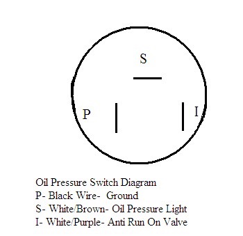

M_Pied_Lourd
Hi Bill,
This might help to verify your connections at the switch...
Cheers
Tush
D

M_Pied_Lourd
Hi Bill.
Just click on the picture. It should open up larger in another screen. Please let me know if that works for you.
Cheers
Tush
