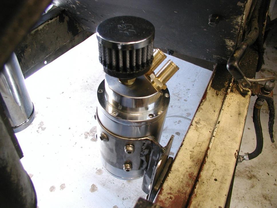

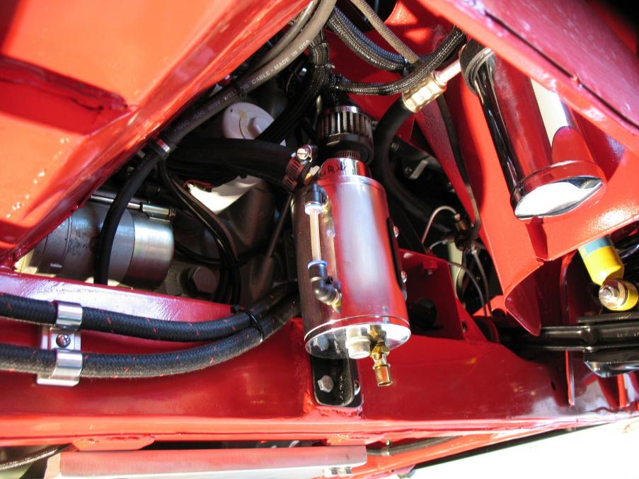

Interesting topic... I have one on my efi car.
I didn't want oil contamination damaging my fuel injectors so I plumbed in a oil catch can. Oil catch cans are standard practice on race engines... which, of course, mine is not. Reedy mades a fairly nice cheap one and I got it. I then modified it to suit my needs and mounted it behind the front right wheel well. I have plumbed both the valve cover and the valve lifter inspection plate (forget if this is what it's called) to the catch can. So intake area is free of oil blow by.
Oh, and unlike the one shown in the article mine is almost never noticed.... in fact, can't recall anyone ever pointing it out.

GReedy oil catch can during construction and final install.
I added the breather, mounting and drain.

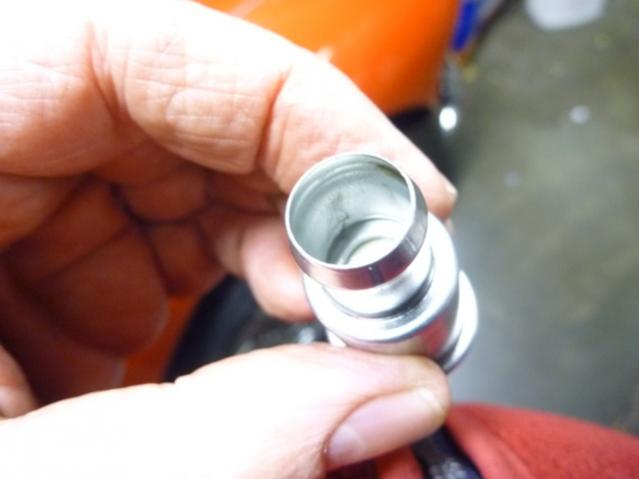

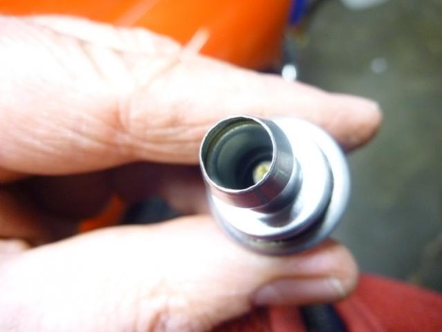

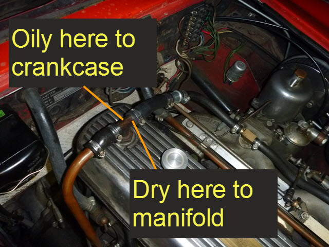

I installed a PCV about a year ago and it seems to be working too well - or not at all. The tube from the valve cover "T" to the manifold is clear of any oil at all and the PCV looks unused.
However the car runs well and leaks very little oil.

Steve,
You can test you PCV valve by removing the oil filler cap and putting your hand over the hole with the engine at idle. You should feel a mild vacuum if the engine is otherwise sealed-up well.
