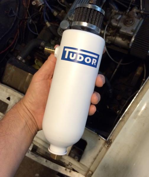

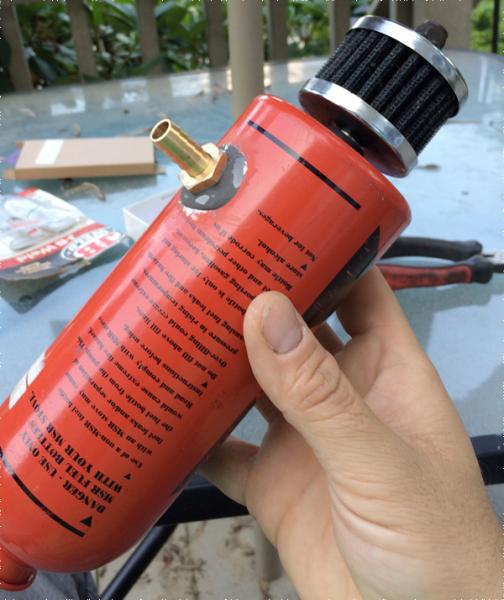

I started with an aluminum tank that came with my MSR Whisperlite Camp Stove. You can also get waterbottles that look like this at Walmart or target, etc. I drilled a hole in the side, fitted a hose barb and glued it in place with JB Weld. Next I drilled a hole in the top and put in a rubber grommet and a breather filter.
attachment.php
Next I masked off the barb, painted everything else matte white and then slapped on a couple TUDOR stickers that I cut at work.
attachment.php

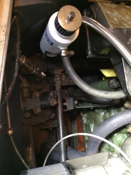

A couple self tapping screws into the radiator shroud hold a bicycle waterbottle holder in place and the new catchtank fits in like a charm.
attachment.php

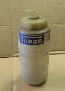

I tried to mimic the TUDOR windshield washer bottles that these cars came with- I think it turned out well.
attachment.php
