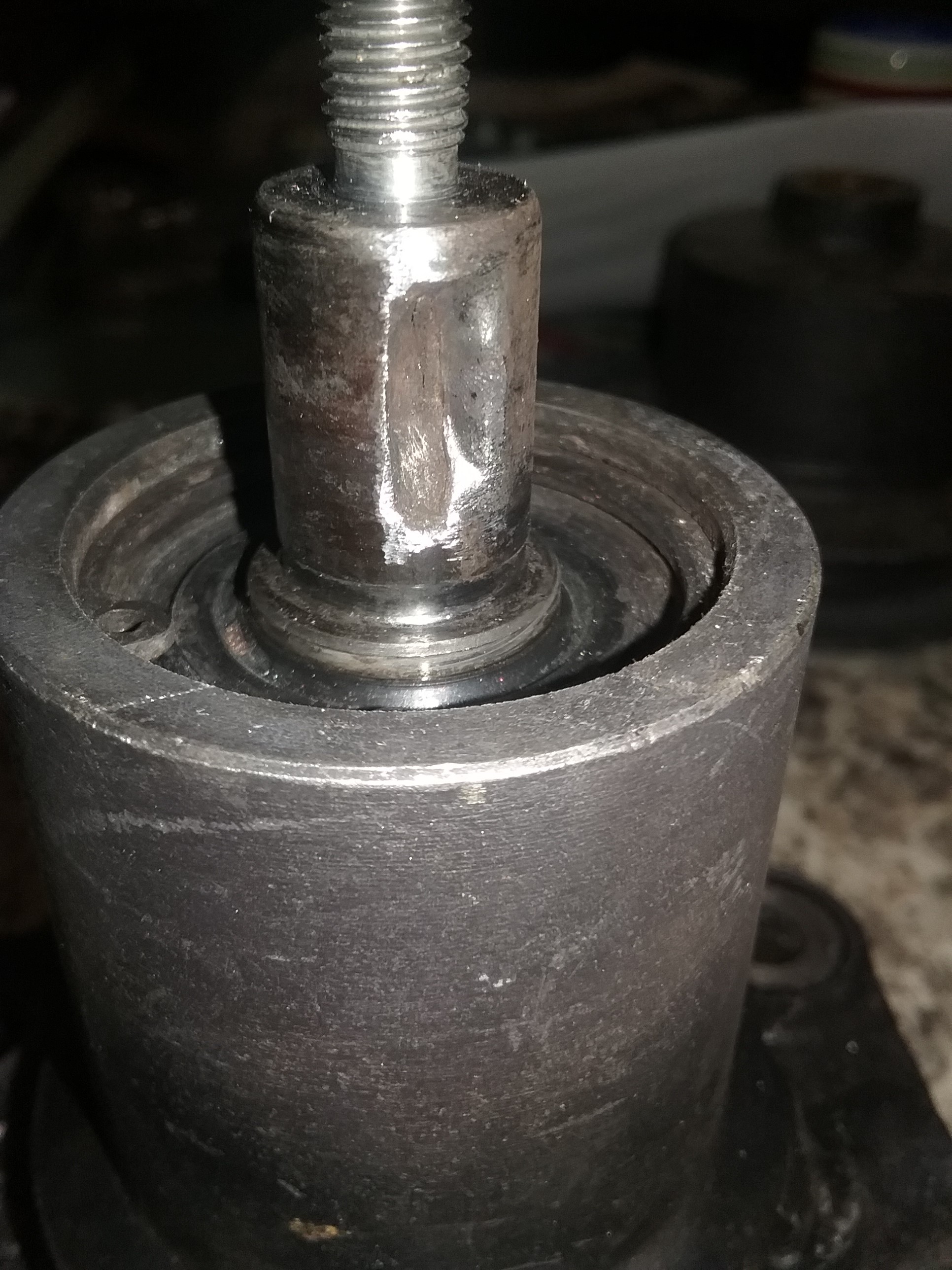

Alternately, I made up a tool for this purpose using some angle iron and 3/8" bolts. Works great, compact enough to pull the pulley with the pump and radiator still in place:
Zerked pumps look nice but finding rebuild parts can be a problem. For the original look I just took the threaded portion off a zerk and JBWelded it to that boss on the pump body. One of my TRs has a functioning zerk... one is the dummy. I doubt anyone can tell which is which w/o hooking up a grease gun to it.

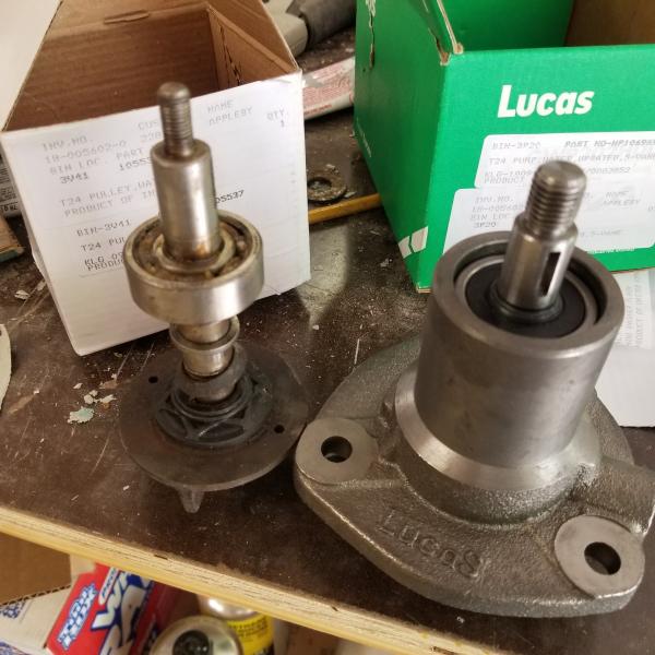

I have just replaced my pump with one from The Roadster Factory. The pump is the 5 Vane pump HP106969 and the pulley is 105537. The 5 vane pump has a larger diameter thread than the original pump. The old pump is on the left in the photo. The shaft size is the same. You need to be sure to use the thick washer that comes with the pump. Also check the key fit in both the shaft and pulley. I ended up buying a new key because the supplied key was lose in the shaft. The pulley should be a push fit on the shaft.
David

Never through anything away even if you replace that pump. It can be rebuilt for a back up. Lots of discussion lately here about the 5 vane pumps. I was one of them that started it. Your asking for trouble if you get one. DavidApp just eluded to the problem. The key way in the shaft is smaller then the key way in the pulley. Initially tightens up but in 400 miles and it did it twice. The pulley comes loose and the key way wears out the pulley key way. The pump shaft was so badly worn the second time the pump and pulley had to be replaced. So do your self a favor and get an original style 4 vane and you'll be fine. Make sure the pulley takes some effort to slide onto the the shaft too. Should be a tight fit. Check out the link to the tread above.
DavidApp
I got a key from ACE hardware that was a good key fit in the pulley but too tight to go in the shaft. Then carefully filed the key to fit the shaft. Taking the same amount of both sides and only filing where the key went in the shaft.
On the original pumps the threaded section is a lot smaller than the bore of the pulley so a special thick washer should be used. Don't ask me how I know.
David
