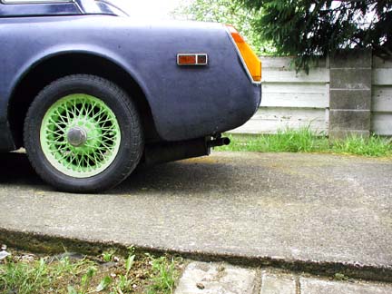

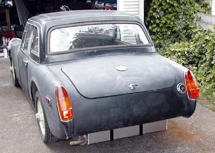

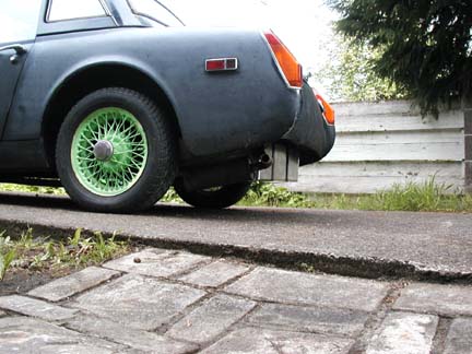

Here's the latest from the EFI project. I was having issues with the fuel delivery so rather than trying to modify the stock fuel tank, I found myself a new fuel cell. I ended up with the RCI 2172A 17 Gallon Aluminum fuel cell. I got it mounted up and now I just need to complete the fuel lines. Here's some pics.

Is that the tank I am seeing or does it have a rock guard around tank, and how low is tank to the ground?
I need a tank that big (for my Bugeye V-8) If you get a chance can you get another photo to give a better perspective from bottom also do you have a link to where you made purchase.
I was worried that I would need to cut floor and install in trunk compartment to get a tank this big
Looks good, need a decal
The question one might want to ask, is do they really want to carry 17 gallons of fuel in the tail end of a Midget, that quite the load hanging out there beyond the axles. I let a fellow (we won't call any names :smile:) drive my race car one time, he needed to add some ballast, he decided to put about 20 pounds and attach it to the fuel cell mounting structure at the tial end of the car, I told him that was not such a good idea, sure enough it made the car tail happy. If you for whatever reason are going to add weight to car do so between the axles not beyond the axles, for obvious handling issues.

Well, I chose this tank, not so much because of the 17 gallon capacity but more because it was the only off-the-shelf cell out there that was only 7 inches deep. Most are 9 to 12 inches deep, even the 1,5,7 and 10 gallon tanks. The stock Midget tank is about 6.25-6.5 inches deep so this one really isn't presenting any more of its bum to the ground. I only had to cut the floor of the trunk where the new fill neck and lines come through. I think the stock tank measure about 26 x 14 x 6.25 and this one is 30 x 17 x 7. In fact, the stocker is almost 27.5 x 16 with the flange. I picked this cell up from Summit racing and again, the determining factor was the depth.
I had to cut all the old mounting studs of and grind flush, then I welded on a pair of hinges with the steel straps so the whole tank swings down on hinges when you undo the two bolts. I still need to get some rubber isolators in there and yes, the muffler is pretty close to the tank so I'll need to get some sort of heat barrier there as well.
For the muffler, I just took the stock two muffler unit and the bottom was rusted out of the transverse muffler anyways so I just cut it off and flipped the other muffler/resonator so the bend points out under the rear quarter. I had to loosen all the mounts and push it over as close as possible to the leaf spring without interference.
It's all shoe-horned in there pretty tight but nothing should be rubbing or dragging! :driving:

This shot is great because you see how it really doesn't hang down any more than the old tank or mufflers. I pushed it as far forward towards the axle as possible so it's not hangin a big bum out back. And finally, this shot actually shows the lime color of the wheels a bit better! :laugh:

And here's the 3/4 shot.
