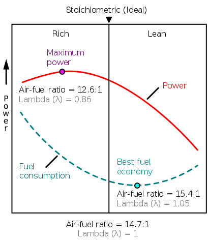

I understand that with a finely tuned engine the power to fuel consumption curve is pretty flat through the normal operating range of an internal combustion engine attached to a gearbox and axle -- why it is almost like a bunch of people with engineering degrees wearing white lab coats did it on purpose. But in the real world compromises are made which result in higher... never lower than the stoichiometric ideal... fuel consumption.
