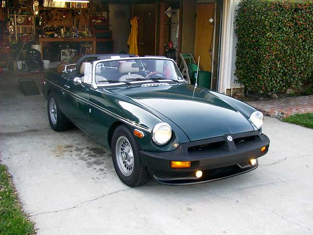

Ok, I admit it - I’ve got one on my 78B (see attached). Now truthfully if I was to purchase one NEW I never would have shelled out the money ($$$) VB is asking. But I got mine on ebay for next to nothing and in fact I kind a like the looks of my B with it.
But is it anything more than just for looks? Welllll, in a nut shell - sadly, no. However I did notice an ever so slight increase in lateral stability or stiffness when rounding corners – less body flex if you will. Some will say that any gains in rigidity ain’t worth the cost and are funds better spent elsewhere. Break it down like that and I guess I would have to agree – but again the ($$) price was right and I couldn’t resist. Truth be told I paid more for the roll bar cover than I did to the seller on eBay.

So, to go a little deeper on the street rollbar question, I am curious. Is the reason they are frowned upon because they will fold - not strong enough to withstand the weight of the inverted vehicle (tube size or design is inadequate), or is it that they are too low to provide full protection at head height (because they need to fit under the hood)? If the former, wouldn't the Autopower Street-Sport Roll Bar (has an extra lateral bar be worthwhile, and if the latter, isn't something better than nothing for a street use car where I need to be able to use the hood? I am driving this B all the time for normal street use, and getting some marginal protection against the unlikely colision and flip situation would, it seems to me, be of some value, even if it is much less protection than a good racing bar. Also, my 9 year old son rides with me, and if head height is the real issue with street bars, then it would appear that I can atleast provide some protection for the child, if not for the driver. Also, would not the placement of the street roll bar provide some marginal additional resistance in an side impact situation? Can I hear a little more from you guys on this?
Thanks, Midgey /ubbthreads/images/graemlins/confused.gif
tony barnhill
Great Pumpkin - R.I.P
All of the above....any rollbar that allows the MG top to be put up is pretty worthless!

[ QUOTE ]
[/ QUOTE ]
At least you said they're "pretty". /ubbthreads/images/graemlins/smirk.gif
But seriously, I think there is a question that begs to be asked here – what’s the difference between the MGB's “cosmetic” (hate /ubbthreads/images/graemlins/rolleyes.gif the term "bling-bling" BTW) street rollbar and those you see on some of the new cars rolling off the assembly lines these days in a true rollover situation?
In My View: NADA! /ubbthreads/images/graemlins/nonod.gif
Granted they probably have better anchoring location and are cosmetically better incorporated into the overall design. But for my money those hoop style rollbars like you find on the new MX-5, Z4, Porsche Boxster & the Mini convertible don’t look like they’d provide much protection as the drivers head still sticks up above them too.
I think we’re reading way too much into this. I mean as hard as I’ve tried I would have to be really crazy in my B to ever make it rollover in the first place. Duh....
