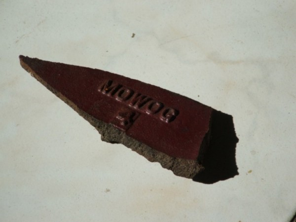

Somewhen in the past I posted a photo of a piece of cast iron block, the "MOWOG" on the side of a block snapped apart from a spun rod bearing:
