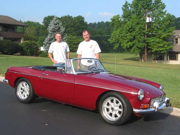

For what it's worth, there are a few MGB V8 and V6 conversions driving around on 15 x 7 tires. It can be made to work quite well...
This MGB is running on 15x7 wheels and 225/50 tires:

Thanks Curtis, best answer yet, didn't know the offset was different, my 15 X 7s are zero offset.
P.S. the B looks nice with those wheels.
